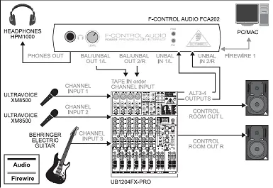

This Kind of Setup?
I was thinking of something like this? Your info is excellent and thanks for pointing out what I had left out. For monitors I have a very good AMP and speakers from a surround sound/home threatre. I'm pretty confused about the whole need for pre-amps and if the mixer is working as a pre-amp or something like that, I'm really not sure. I have tried to include a picture that shows what I am trying to do. Please correct me if this is incorrect or it is not a good idea.

The signal routing diagram is OK. Well, except I wouldn't plug the guitar directly into the mixer for the reason I said before.
...I'm pretty confused about the whole need for pre-amps and if the mixer is working as a pre-amp or something like that, I'm really not sure.
The mixer you listed has four built-in preamps. Mic's need preamps to boost their output up to line level. A mic is connected with a cable that goes to one of the four XLR jacks at the upper left corner of the mixer. And you need a mic that has a balanced output, not a computer mic. The microphone forum has stickies w/ lots of info on types of mic's.
