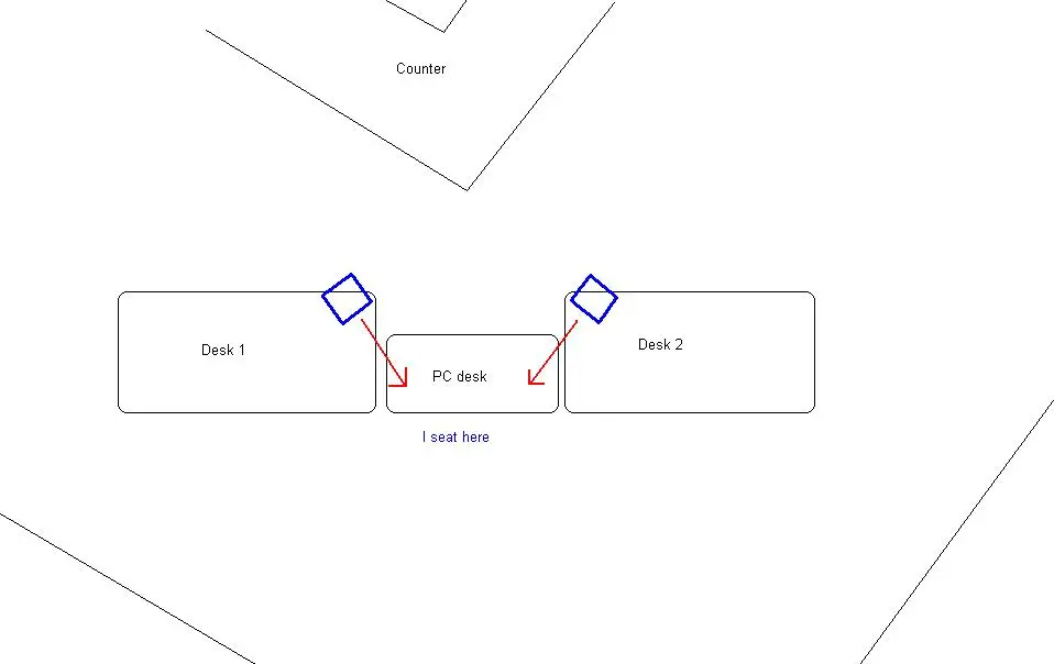

Here's a little background of what my workspace is like:
I have my mixing PC here at my pharmacy (yeah, I know, odd place;)). I have it right on the sales floor. I mix at my lunch hour, while the pharmacy is closed.
Virtually, I can't modify the room I'm at; it's a huge space (65'x65') with tall concrete ceiling (about 10'). My desk and PC is located at one corner of the sales floor. The first mixes (the ones that were really bad) were done with the speakers placed to my left and right, on the floor.
Now, I have them in front of me, placed over the corners of the desks, and it sounds much better.
My PC being on the sales floor is one of the main reasons I've been mixing with headphones for so long.
Thanks for all the input. It has really helped!
Cheers!

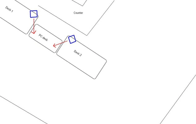

Nico,
You sure your problem isn't that you have been hitting the Vicodin & Demarol supplies in the stock room a bit too hard? Siesta!!! ;) :D (just kidding :) )
If you're sitting in the corner, that could very easily be messing up the bass in your monitoring. If you can't change your situation, there's probably not a whole lot you could do other than to try and learn how to compensate for the artificial bass boost - which might be tough to do well. But in that kind of situation there's no guarantee that even $2000 worth of monitors will help much; the room will mess with those just as much as it will the lesser monitors.
Can you get away from the corner at all? Even if you could straighten the tables out and get yourself out of the corner and your back away from the back wall, that might help a bit. Is there a way during lunch that perhaps you could push your desks up against the counter, for example? See attached.
G.

Glen,
I'll try moving them today, but I know it's not going to be an easy task. I hope I have enough time to move them back before opening time.
Thanks again mate:)
