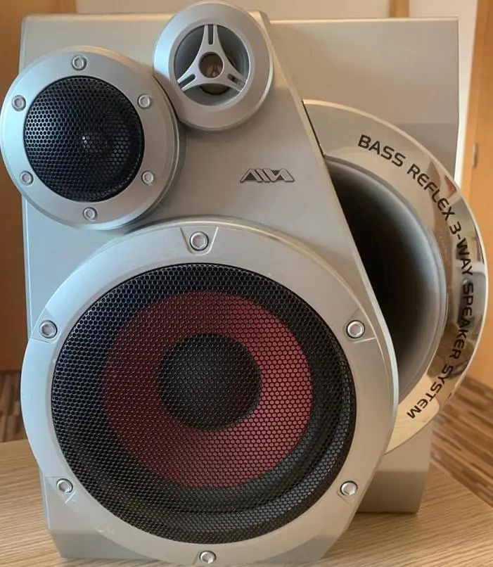

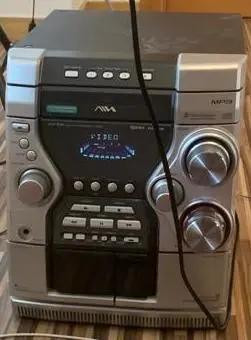

here's my setup to listen to music : mac book pro, outputting to focusrite scarlett solo sound card, going to an old hifi with speakers (see photo attached). I am in a room that is not treated for sound. The environment is quiet, but there will be sound bouncing against the walls.

- what do you think of these speakers (6 ohm, made by sony a while back. definitely not specialist equipment) ?
- what do you think of the hifi itself ? Does it matter at all, given that I just set it to "aux" ?

If you have a budget of $1500, I don't know why you would not want to get a decent of monitors and do some acoustic treatment? Otherwise, invest in a good set of headphones.
Pretty much what he said ^^
Forget that stereo, or at least set aside and use it as a point of comparison.
Instead spend some time looking at what's within your budget in the way of powered monitors. These will connect directly to your Scarlet, and, so long as your room doesn't trip you up, will give you a more accurate and dependable sound.
+1. The biggest issue with using consumer hifi gear is that a lot of it alters the audio to make it sound 'better'.
Anything advertising mega-bass or super this or that isn't going to be giving you an accurate representation of the mix.
What you want from monitors is the truth.
There's plenty of 'hi-fi' gear that can be very useful, like simple amplifiers from Yamaha/Denon/Marrantz and speakers from Jamo/Kef/ect,
but anything that looks, or sounds, like it has bells and whistles probably isn't going to be that useful for accuracy.
An old MIDI/Mini system, that has very little to do with quality sound. Although the amp in in, set to aux is pretty useful but the speakers are horrible. They look great and sounded like a dogs dinner. Boom bass, tinny HF and a dull mid - turn them up and they thumped well. especially when you used the preset EQ curves. These of course are pointless for recording because you want truth not flattery.
There is a problem with Hi-fi enthusiasts, compared to music producers. They claim to want truthfulness but they actually want a rather strange sound, from our perspective. Not bad, but they want audio that flatters the source material, and we don't. We want as much as possible, reality so we can make sensible adjustments, knowing that Joe Bloggs in the street will tweak to taste - like adding salt to a meal in a restaurant before even tasting it.
Plenty of studio monitors at sensible prices, and plenty of room treatment available too.
