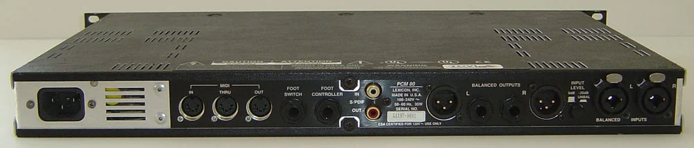

You would probably want to go analog. The PCM80 only works at 48k, so you wouldn't be able to do a 44.1k (88.2k, 96k) session and have it hooked up without the world coming to an end. Dealing with the clocking issues that come up when you are trying to do stuff like this is never worth it. imo

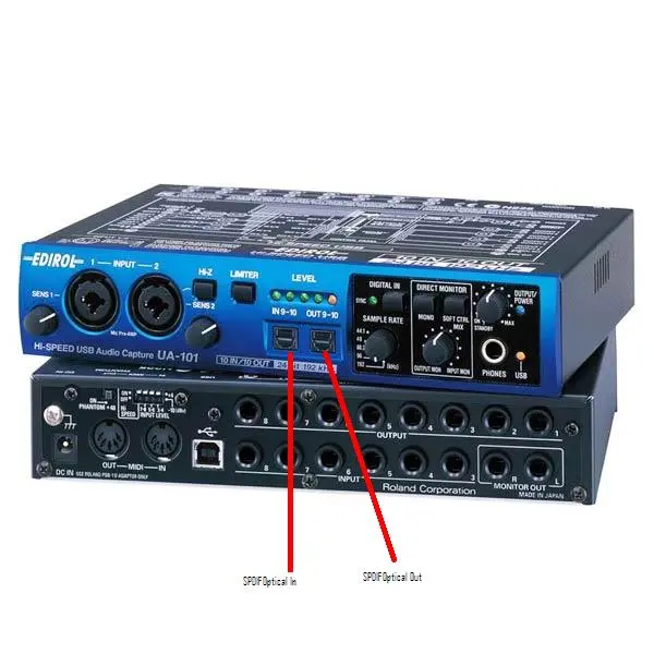

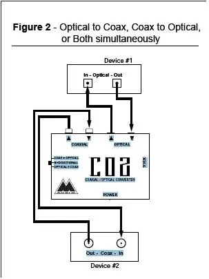

The EDIROL UA101 has Optical SPDIF In/Out, whereas my Lexicon and TC are RCA (coaxial??) In/Out. Never knew it was called coax but whatever....Not sure why the Optical SPDIF was on there - maybe it's the new technology...
The MAUDIO CO2 is a bidirectional converter that will convert as needed.
I'm thinking that the EDIROL could go between my mixer and my computer, although I could eliminate the mixer completely I guess.
