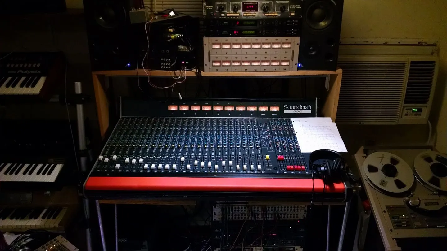

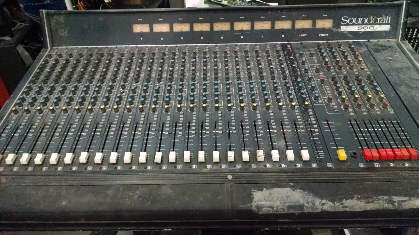

I just got one this summer in real rough shape (looked like it had been toured hard and put away wet) and totally went through and fixed everything. I absolutely love it. You won't be disappointed with any aspect of this board if it's in good operating condition, but due to the age of these I imagine most of them have some issues. The console is totally modular so it's very easy to service.
All of the switches for assigning, solo, etc were very noisy and intermittent. You might have some luck... temporarily... putting Deoxit into the switches but I went ahead and changed out all ~300 of them with brand new Alps parts since I was pretty sure the board was a keeper. With a Hakko desoldering gun this is a moderately satisfying repetitive task. Some cold solder joints on pots at the ends of the module PCBs but no problems with the pots themselves.
Before and after:

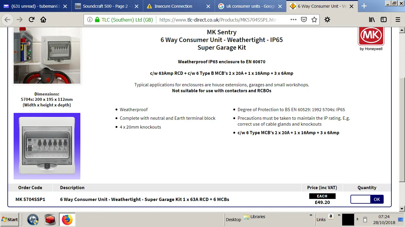

I am UK of course but the above looks fine for £50. Six breakers with RCD protection. I am sure you can find something similar.
16A at 110V only gives you 1,760 watts for all the gear and will all those amps, inrush current could cause nuisance tripping. I would be inclined to have two "gear" spurs? One for "sensitive" kit, tape machine, mixer, pres and a computer/interface (washa-ma-mouth!) and one for more "chunky" stuff, valve amps, synths.
Lights definitely on a separate breaker. Be 6A here so I guess another 16A for you unless you can get 10A breakers? Our power circuits are on 2.5mm sq copper but lighting on 1mmsg for economy so fused at 6A (still all massively conservative ratings)

The link I copied and pasted in says "page not found". Last night I had to move to Firefox, old browser would not send attachments so I guess that is another *&^%$£ker! I shall have to sort out!
"A picture's worth a thousand.....
Just come from trying that link on a UK (sos.com) forum and it works fine. Firefox have some sort of security issue but with whom I cannot tell.

220V? "Nominal" 230V or the 240V+ I usually get? No matter, even 220V give you over 3kW, more than enough.
I don't know how long the "run" would be but I would take a chunky 4mm cable right from the meter cupboard and bring that to a consumer unit similar to the one shown. Of course you really only need one 16A breaker in it but I would get one with built in RCD. Old house so bet nothing in the cupboard?
