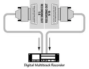

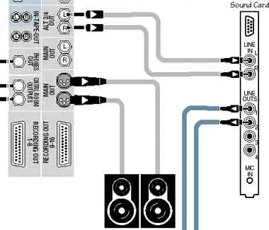

If you look at the PDF manual for this mixer the instructions are pretty explicit.
The digital outs that are causing you concern are used when outputting to a digital multitrack recorder, not to a PC. The two attached images show the Onyx attached to Digital Recorder (Mackie Onyx 1620 to digital) and attached to a PC (Mackie Onyx 1620 to PC).
Offhand, the firewire option may be THE way to go. Regardless of whether or not you are using a laptop.

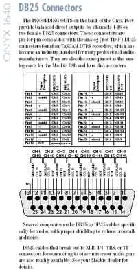

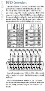

Here is some more info from the Onyx 1640 PDF manual. Image attached.
Sorry the image quality is so poor... a sacrifice made for speed. At least you know where to look.

That isn't a TDIF connector. It is a D-sub connector. It is the way Tascam DA-xx have their balanced analog i/o configured. You just need to buy the right cable for it, they make them with all kinds of different ends. (1/4, xlr..etc)
You're right! I should have looked at that drawing wheelema posted a little closer. I saw "TDIF" in the print, but didn't see the word "not" in front of it! :mad:

Ok, this is what it looks like to me. I am just trying to understand all this. It klooks like you could either take the two balanced outputs and connect them to two balanced inputs and do a live to two-track or you could take a 25-pin connector from that thing on the mixer labeled "recordin outs" and input it into the 25-pin connector on the M-audio card. Would this work? Sorry for the headache and thank for bearing with me.
No, this is an analog connection. One end is the 25-pin connector, the other end is balanced TRS or XLR jacks.
The connector on the Delta is a 44 pin, not 25, so it wouldn't be possible to connect them directly.
If you had the pin-out for the M-Audio, then I suppose it would be possible to make your own cable that would work, but that sounds like a lot of work.
Ted
