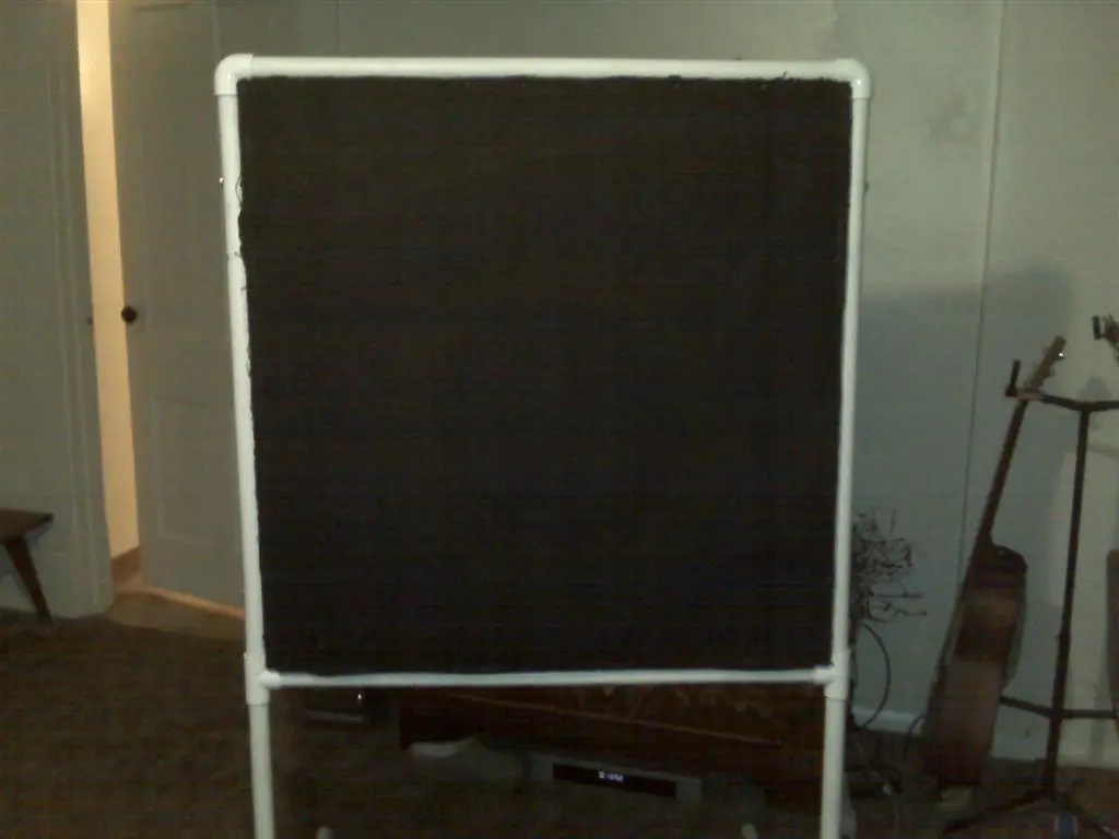

Hey yall here is a DIY that I did myself tonight I used 3/4" pvc pipe a piece of 1/8" paneling and the roxul mineral wool insulation aval. here it is 2" thick w/ the burlap material I am gonna lay a couple tracks to see how well it works in behind a mic.

Looks good. How did you attach the paneling etc to the frame if I may ask?

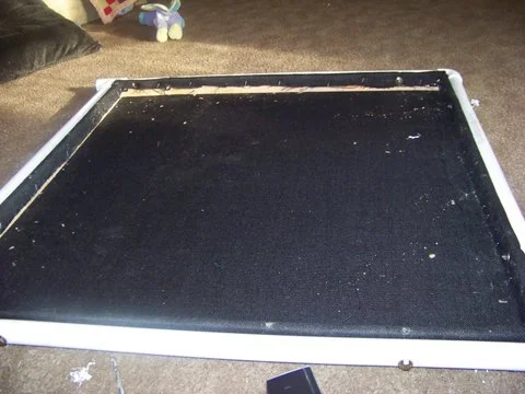

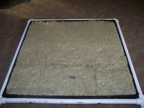

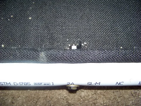

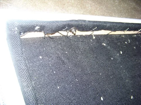

ok I will be making 3 more of these and I will take pics as I progress through the process. I used simple 1" X 2" boards the pvc pieces are 36" joints I mounted the wood to the pvc using 3/8 bolts and nuts. I plan on attacking another one today. So hopefully I will be able to post some pics later this evening or tomorrow. Hope that this helps some of you all.
after finishing one today it is a bit heavier because of the wood I used on the back and grant it that most of the wood is stuff I have lying around the garage and basement. I wish I would have used 1 and 1/4" pvc for mine but it will work for now I will be getting 1/8" subfloor material for the backs one day next week when I get a day off from my real job. Here are a few more pics though.

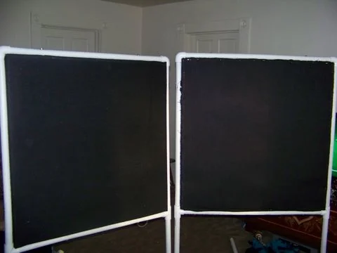

one more pic of both side by side.

made a mistake in the material list sorry about that I listed that I used 3/4 " pvc when it is actually 1" pvc
