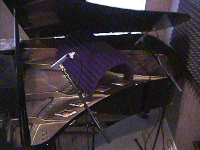

Harvey Gerst said:
Ok Michael,
...Try putting some kind of padding between the two mics, like a piece of foam, or any kind of sound absorbing material. Move it around inside the piano, towards the low mic or towards the high mic to see if you can cut down (or breakup) the cancellation, without affecting the overall performance of the piano...
OK, I did that. Attached is a picture of the set-up. I think it worked very well! You can have a listen here and let me know what you think.
The chain was as follows: Mics>>Audix 35102 pre's>>Steinberg 8I/O AD/DA converters>>Nuendo recording S/W recorded at 24 bit. There are 2 samples there, one with the on-board EQ of the 35102's and one without. The samples are short riffs spanning about 5 octaves.
Please let me know what you think.
