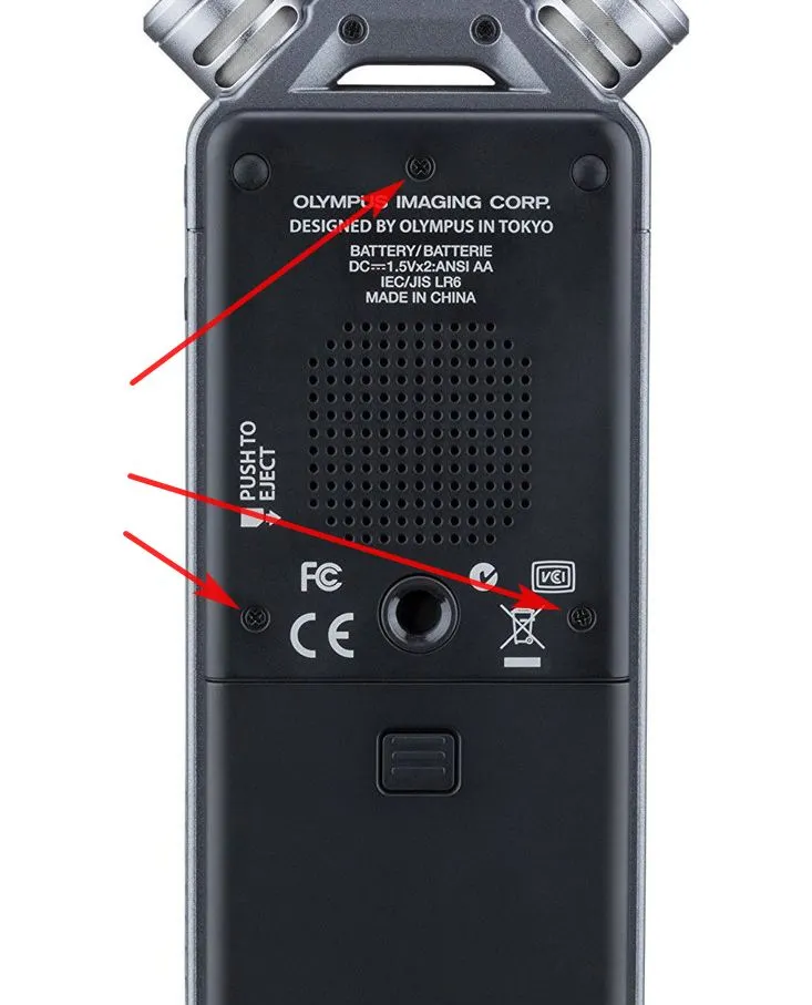

hi, excuse the over the top headline. I bought it on eBay, it does work but I'm having trouble dismantling it for cleaning, does anyone know of a schematic to show how to take this digital recorder apart. Many thanks

Yup, return it if you can, but if beyond the time you can, how much can you get to removing the Phillips screws on the back? Couple Allen screws on the front, do they loosen anything up?
