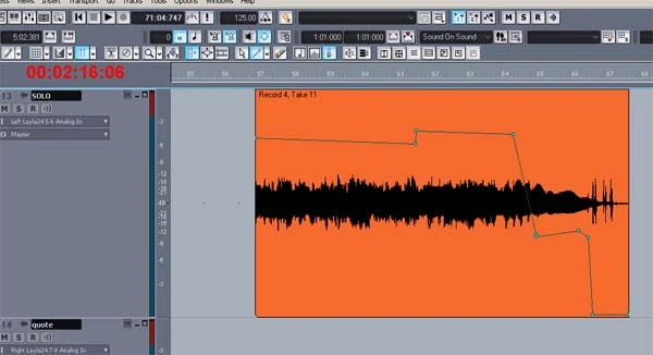

As far as the automation goes I don't have cubase but I bet it's similar to sonar.
Hopfully you put each drum into a seperate track as audio?? If not start doing it:) Right click on the kick track in the track view window. See if it says add envelope or automation. if so add a gain envelope. You will be able to add nodes (better known as dots) to a line that runs the length of the track. when you add those nodes the are points at whitch you can start to change the gain. To change a selected section without changing gain on the whole track make two nodes on each end of the section you want to change the gain on and then drag the middle up or down. The space between the two dots on one or the other end is the fade. further the nodes are apart, longer the fade. I'll put a picture. It's pretty easy just pich a test file and screw around.
Other option is cut the track into the loud and quiet sections. try right clicking on a section and look for adjust gain or volume. Might have to highlite the section and go up to edit in the top left corner of the screan and look for a similar comand.
Hope that made sense :o :o In a bit of a hurry. Let me know if you need more help.
Later
F.S.
Below is automation or a gain envelope of a solo that due to notation needed to be adjusted to keep the same apperant volume and then was faded down quite a bit and sharply cut off at the end. The fades look really fast in the picture because of the hoizontal zoom level, but the solo is 11 messures long at 125 bpm. they are more gentle than appears.
