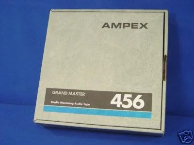

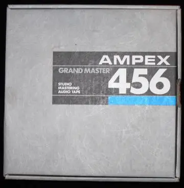

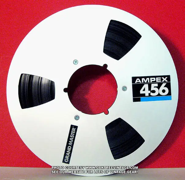

Did Quantegy change the front box logo & design around this period when they took over Ampex? I notice some of the last Ampex boxes have the black box logo towards the bottom & light blue logos on reels instead of Blue / Black bands?
Don't know exactly if this is the time that the sticky shed ended but I've noticed that the Blue logo reels & bottom box Logos seem OK when I've used them?

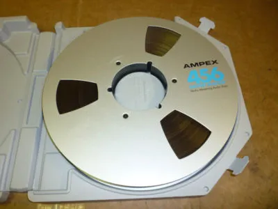

The ones with the logo in the middle of the box are usually bad. Logo at the bottom is late era Ampex, and they are all good, AFAIK. Reels with the open logo silkscreened onto the flange are also later tapes - ones where it's a sticker with a black background - I have one from 1995 which I believe is good (but ought to test!) and all the others of that type were bad and reused for pancakes.
EDIT: Also, if it has a sticker with a little rainbow pattern, run away.

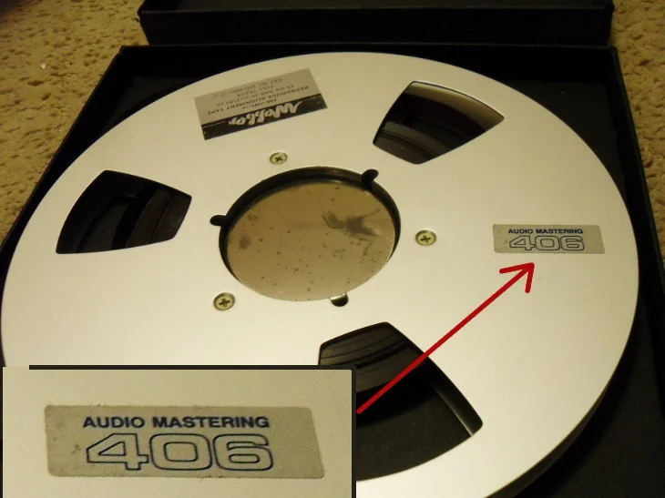

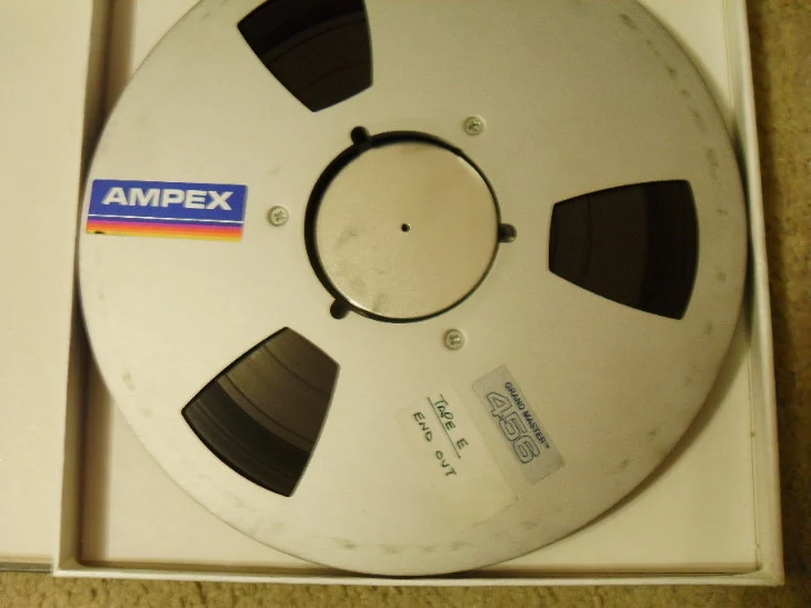

Okay, here are a couple of mine.
First, one of the dreaded rainbow logos:
...note also the hollow '456'. This came in a good box from 1997, but whether this is '97 tape on a 1970s reel or what, I don't know. I bought it off ebay during the tape crisis but never used it.

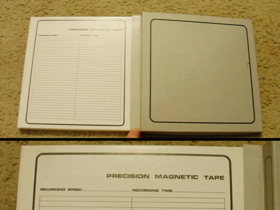

Next, a Webber test tape. It cost £20 off ebay, and would have been a bargain had it not coated the transport with some horrible white stickyness. (There was me wondering why the 10Khz response was -15dB down...). It was a calculated risk.
...again, note the hollow 406 logo.
This was an empty spool, but there are boxes like this with tape in them. I wouldn't trust it as far as I could throw it.
