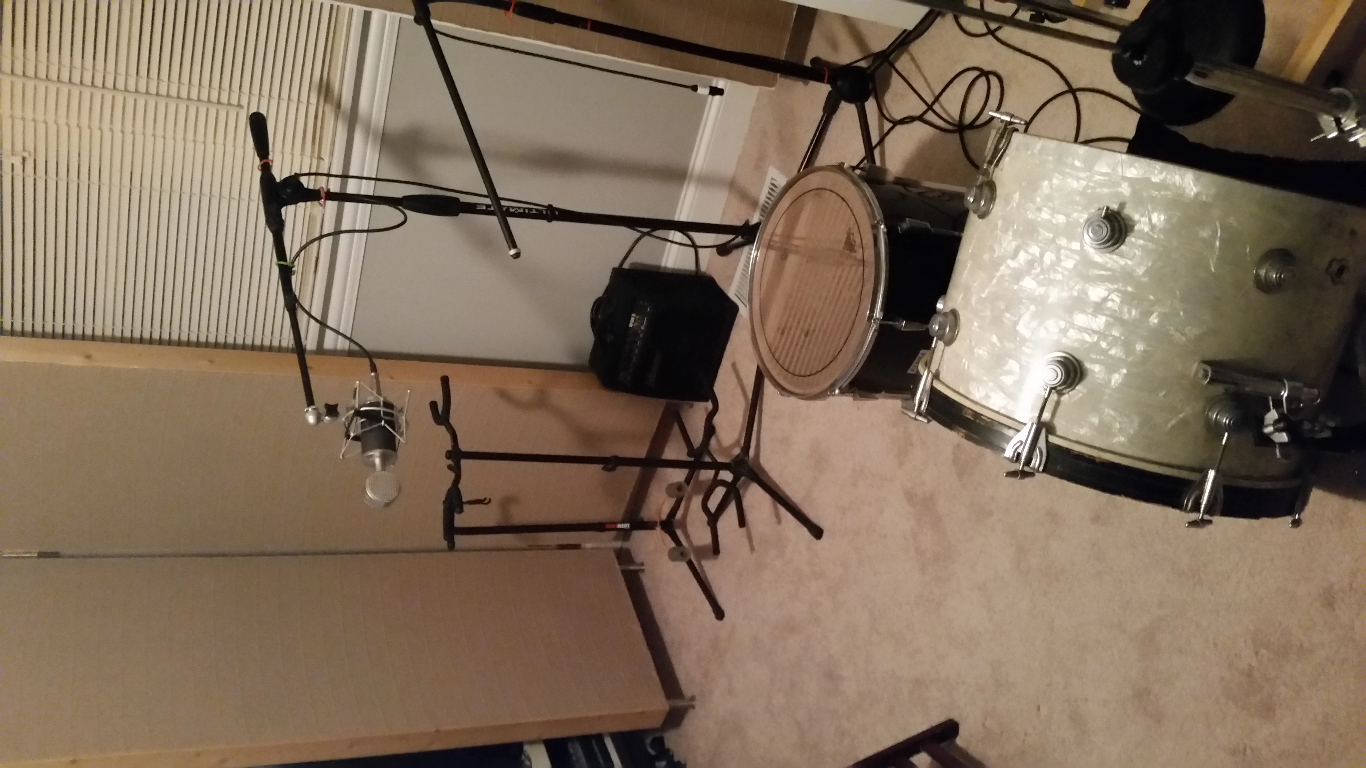

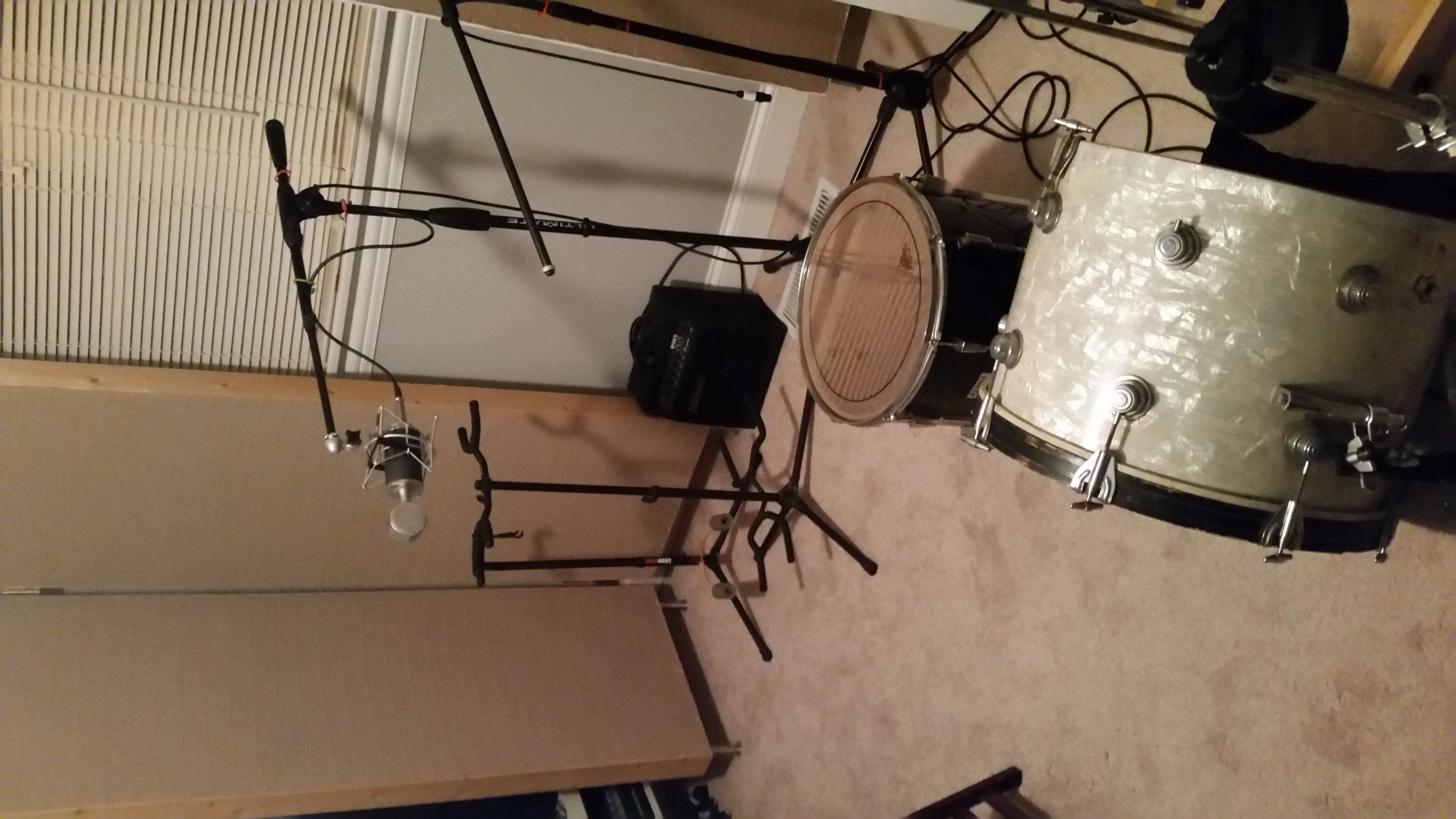

These were made by me, very similar to Atkron 205's traps, about $30.00 or so per panel. I hinged them and added feet so they could be placed just about anywhere. I usually place a small folded blanket in the area where the hinge is to block that little bit of long narrow space. I also have similar traps in every corner, covering a good deal of the walls, and suspended over the mixing spot (the room pictured is not the main space). If you can work with wood, simply make these. I've made about twenty, mostly 4 x 2 feet, but smaller and larger too--the ones pictured allow 6 foot tall me to sing into a mic that is in the center of the folded traps, which are about 80 inches or so. You'll save a ton of money, and it's pretty easy. You definitely want a pneumatic stapler/nail gun though!
What did you fill them with that was that cheap?
Fiberglass. R-13. I started using Roxul after about 10 of them or so. The bigger panels, at a full 6 feet tall, were probably a bit more, maybe between $35 and $40. The wood sides (1 x 4) were pretty cheap, not like now! Those six foot panels now would probably set me back about $50.00 or so for material now. The fabric I got at Ikea--it's actually a cheap comforter that I got on sale and cut up.
Addendum: I did forget something: Those adjustable feet, and the hinges. That is an additional $20.00 or so, but most of the panels don't feature those extras.

R13 fiberglass is not really good for panels unless you get it very thick (like 24"!).
I know. But there was a very noticeable difference in the room acoustics. I know this because before I put the traps up, it was like an echo chamber--when we played, there were constant issues with howl-around, and recording was a waste of time. After the panels went up (all of them R13), the difference was very noticeable, and recordings made in that small room turned out very well indeed. Correct me if I'm wrong, but 24" thick battens are no longer R 13, but more like R 30, no?
Ok, what you got rid of was the flutter echo, which, yes, can be very noticeable in a sheetrock walled room. This means the bass is still bouncing around until you treat the corners (especially) with rockwool or compressed fiberglass. If you don't record/mix anything with low end (bass, kick), then its not so much an issue, but you can notice the difference if you put on some music with strong low end, then move around the room and listen how things change.
R values are for thermal insulation measurement, don't really mean anything for sound.

I get that--my referencing the R value was just to make that point about the thickness of the stuff. In the room I was referring to, there was shiny, cheap paneling over plaster. The ceiling was a type of interlocking "acoustic" tile, which seemed to be a real benefit acoustics-wise. The gobos were on all the walls, and in corners, though not up in the ceiling corners themselves. While I understand that they weren't going to be the best, they did help a bit with bass frequency control--on the kick drum and toms for sure. Of course I record bass guitar and kick drums; the kicks are/were recorded live in the room, and I got good results. Bass guitar was alway injected right in; no amps. The actual mixing was done in another room, and that room (as well as the recording room of course) was not ideal, but the use of many of the traps I made did make a difference not just with flutter echo/high frequency issues but lower frequencies as well.
