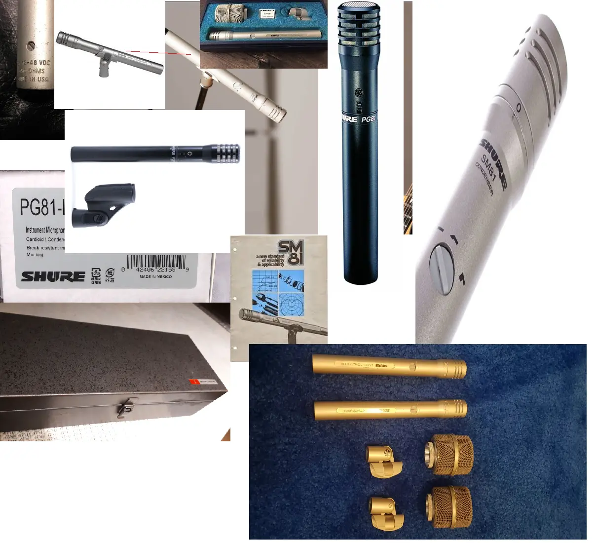

US or Not?
SM81 seems the simplest way to determine USA made is the flat label on it. However not 100% sure what and when the label disappeared and the body is round and champagne color became the standard. Im curious though.
I asked Shure "whats going on with some saying the SM81 changed a lot?"
Reply:
There is no "new" version of the SM81. Nothing has been changed aside from some cosmetics and location of manufacturing over the years. The same machines and designs are used for this mic.
Applications Engineer | Shure, Inc.

New $
$349 SM81
$139 PG81
Used SM81 $200 - $300
Used PG81 $50-$60

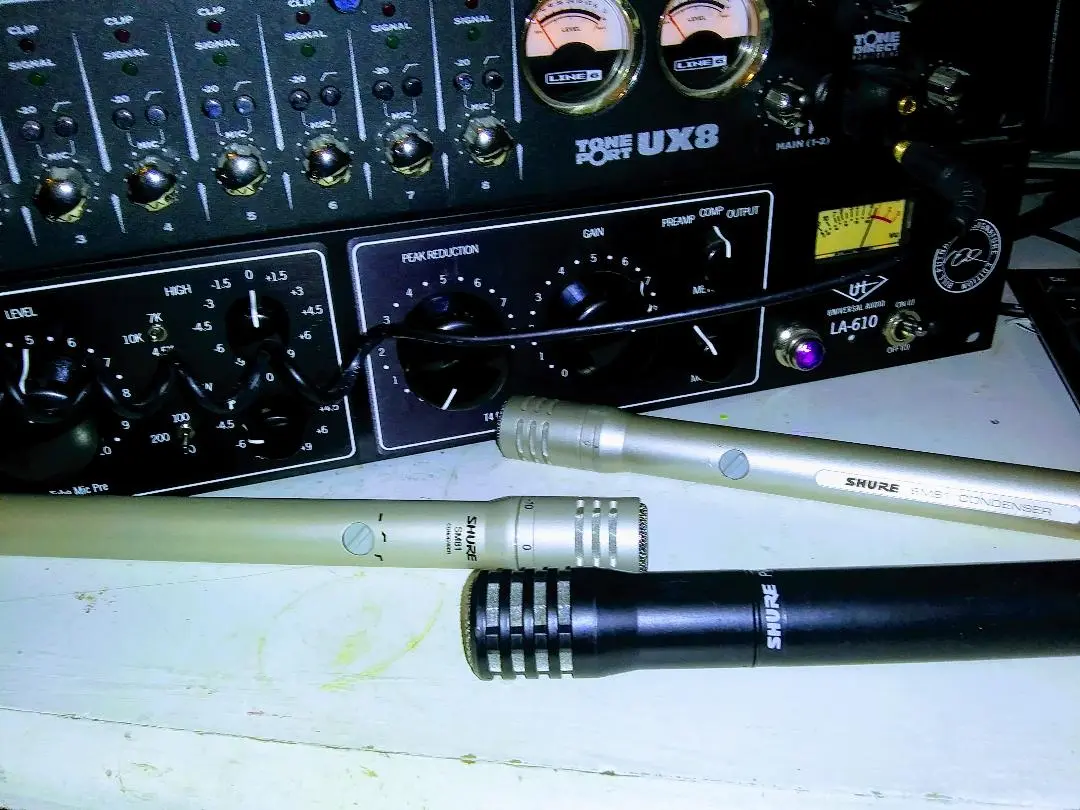

Review end... playing these three, as singles on the acoustic, in the noisy room....
1) all did well at cancelling the room noise, to some extent, with attention to the mic position.
2) all three expect the player sit fairly still or the pattern drops off quickly
3) Pre Z of 500 or 2K has a big influence , the latter really gets the condenser sound while the 500 is flat, less sizzlepolish.
the PG81 $50 used, with some eq I probably couldnt tell a difference in mix.
the new 81 vs vintage 81's were harder to tell apart. actually I couldn't really tell them apart... capsules might be slight newer or older I dont have that kind of ear to hear miniscule difference. Some say they added top end to the newer 81's , I dont know.
I got a great deal on the old ones $175 each with the wierd cap (ill never use) and the champagne mic holder (ill never use).
The new 81 was $239 and has the case and foam and black clip. ..but Im not going anywhere.
One of the vintage US 81 had a crackling, sound I thought..alright! ripped off!
Took it apart and its some weird socket XLR so I cleaned it up and problem fixed (also found some chat/posts about some XLr issues on these...internet is great for repairs.) These days I enjoy tinkering tech stuff as much as playing.
now I have 5 qty 81's and only need 1qty ...:guitar:
I see below a 2008 HR PG81 vs SM81...
ADD> 4days later and playbacks and reference tracks of Blackbird/McCartney-White Album.... due to subtle mic movement making such a sound change on close micing I don't see a need of any of the comparison. PG81 does great, the new SM81 and vintage SM81 don't need my review, but the Shure quality is there in all of them. The vintage one has no sign of the electret being quieter imo, the huge difference is mic positioning..so the PG81 does offer battery operation if that's something...this gear test drive shows "move the mic position" is the big tone dog. $50 each PG81 used, the Vintage US made SM81 is a great deal I could possibly sell one and get this one for free...which is what I'll probably do...the new version return to the Used section of GC with a loss of shipping $$.
