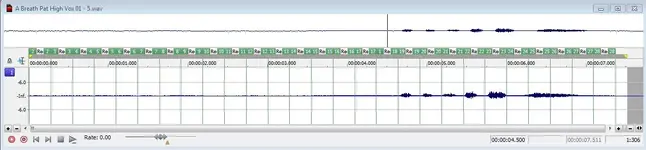

Hi guys,
I am currently on the fence of re-purchasing a Shure SM7B mic, and I am hoping someone could help me out here. I had one a a few years ago, but decided to sell it because I did not have a pre-amp to run it through, and my audio interface had a low signal volume with this mic.
I am using a Line 6 UX8 interface. The 8 XLR input channels all have a +60db on them. A few years ago when i had the SM7b, I recorded a metal band's vocalist with it. The project didn't turn out to bad, and I thought the vocals where pretty good. I ended up selling the mic, and I think it might have been a mistake to do so. But I was hoping for some feedback first.

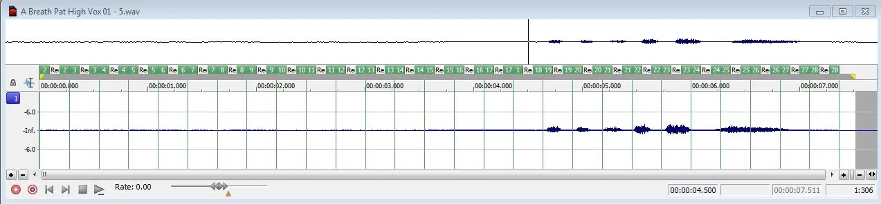

Knowing a bit more about recording now then I did then, I decided to pull out the tracks I recorded for that metal band a few years ago. If I remember correctly, the UX8 input knob for that mic was cranked to close to max. Looking at a couple clips of the audio tracks inside Sony Sound Forge, I am seeing that the max level they get to during growls and screams is -16db on the higher screams, and -24 on the lower ones. The tracks sound clear, with little to no room noise on them.

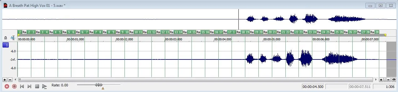

Now, I was told on other forums that you should never 'normalize' a track, but in this case I gave it a shot. I used Sound Forge's 'normalize' feature set to 'peak volume' and boosted it about 50% to a peak of -5.00db. When I played the track back, it sounded a lot louder of course, and still had a clear tone to it without a lot of room noise being present in it.
I have posted a couple pictures that shows a difference in the signal. The beginning of the track the vocalist is silent, and you can see where he starts screaming towards the end. Is this a way I should/could go about getting a higher signal with this mic? What are your guys thoughts?

The suggestion about the fethead and cloud lifter are good ones. They are just what you need to get the signal up enough to not have to crank the input on your interface. A lot of interfaces get noise when turned up that high, this avoids that.
As far as normalizing goes, all it does is turn up the volume so the highest peak ends up where you tell it. It' s usually unnecessary.
The reason people advise against it is because a lot of people will normalize everything to 0dbfs and then try to mix. This causes all sorts of gain staging issues and is just bad practice.
If you simply record all the tracks so that the average signal level (not peak level) is somewhere in the -18dbfs range, with peaks no more that -4dbfs, you should be just fine.

As to the normalizing question, you are just adding gain to a set peak threshold. The noise floor also comes up with that. Not really what you want or need to do.
Steeno has given the correct advice here.
