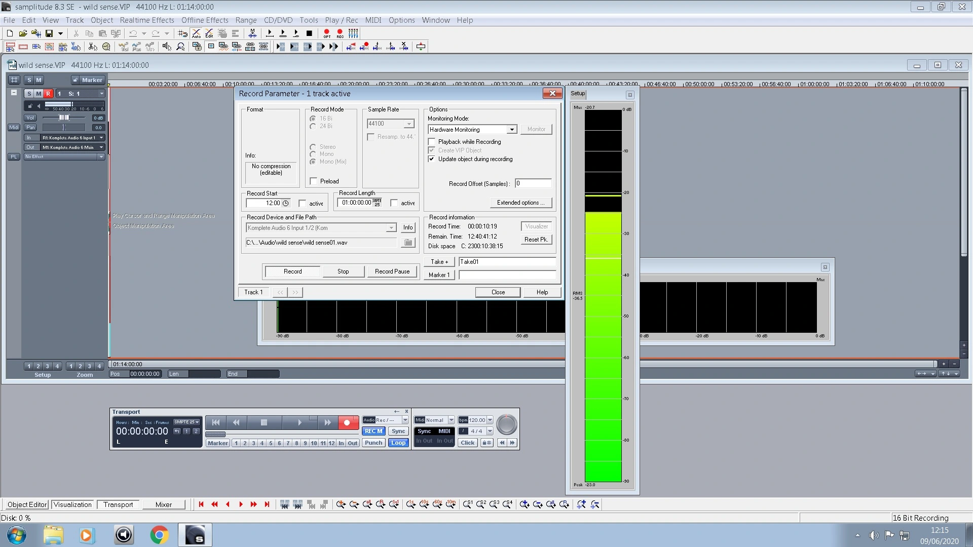

In the attached clip the mic was a Prodipe TT1, I no longer have a '57 but the TT1 is less than 3dB more sensitive than the Shure so, in the ball park?
The mic was touching the fret of a cab containing a Greenback 12" 55Hz model and driven from a Blackstar HT-20 on clean channel.
If the track seems a bit...'rough' please bear in mind it was MP3 then converted to .wav (which of course improved it not at all!) then, re amped from a laptop. Reproduced from a guitar speaker, recorded as .wav then turn back to MP3 for attachment!
You can see I hope the level in Samplitude? The mic fed my NI KA6 and gain was advanced to 3 o'clock, i.e. a fair bit in hand. The KA6 does not have the gainest preamps but they are very quiet.
In the room the sound level, some 1.5mtrs from the speaker was around 75-80dB C. That is a loudish TV but would not I would have thought cause any problems a wall away.
WERE this a problem there is clean gain left in the KA6 and the amp's level could be dropped accordingly. Or one could try a capacitor mic such as one of my AKG P150s which are about 10dB hotter than the dymo.

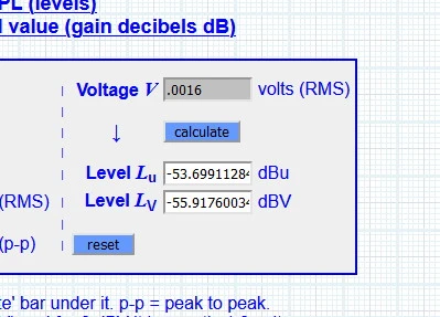

The SM57 has a sensitivity of 1.6mv/PA or -56dBv/PA. The dBu equivalent is about -54dBu. I think the Axe would need about 17 dB more of gain to get to 0 dBFS in the interface. I'm thinking that trying another interface may prove this out and not a problem with the mic or cable. Guessing whatever interface you may try will be in the ballpark of 54 to 56 dB of gain.
FetHead would work if you find you do need a gain boost.
dB dBu dBFS dBV to volts audio conversion digital - calculator volt to dBu and dBV dB mW SPL dB decibels 0 dBFS - convert dB volt normal decibels relatioship relation explanation analog audio absolute level true rms convertor converter decibel to dbf

Mark, OP does not need to get his signal anywhere near 0dB fs.
My screen shot shows a level of around -25dB fs. Sods law, where it was when I hit the tit! In fact is was around -20 and peaking to -15dB.
