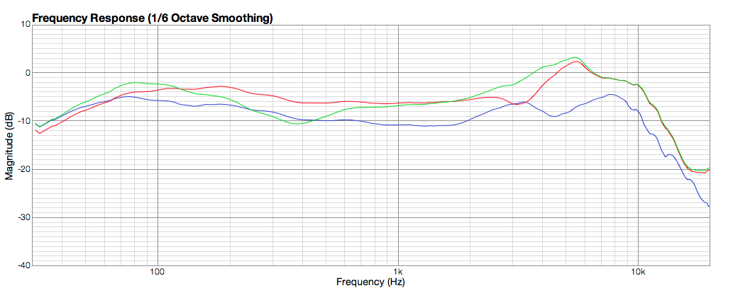

Here is the 320 and 20, side by side. The RE20 is in blue. The 320 in red and green.
The noticeable difference between the 320 and 20 is the 6db difference around 5kHz. It should sound more hyped in the high end. If you see, the difference in bass never passes 3dbs. And the whole bass thing should be negated by the extra dbs across the entire spectrum. Not only is the overall mic louder, but it should be a more treble heavy mic. You can see the response on the 20, and see how each end is relatively the same height (+/- 1db). Not the same for the 320. Seems the the 5kHz is 5dbs higher than the peak of bass, which is 90Hz for green and about 190Hz for the red.
So, what am I missing here?

And I want you to respond to my post on the frequency response of the RE320, as it is not what you described.
