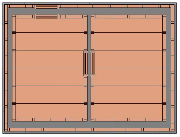

If i were to do it again, I wouldn't waste my money on a normal shed. I'd slab, lay rubber sheeting, then frame the room(s) you want, all unconnected, then frame a structure all round as the outer shed (leaving as much space between the inner rooms and outer shed as you can). -Shown below-
Make sure that the roof/ceiling is the same(unconnected). Sheet the inner room(s) with sheets of plasterboard(double thickness if you can afford and the structure can support), and the outer with plywood(again double thickness and on the outside) and clad as you wish.
Make sure to install some kind of ventilation in this process though! And the electrics, etc.
I wouldn't install a window. Although it is nice to have some natural light, it'll be a lot harder to isolate than a simple wall.
