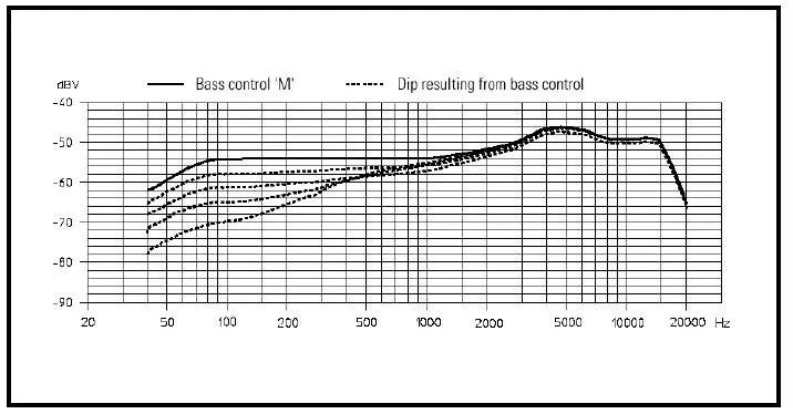

Maybe this will help:
A few words about the MD421 and Proximity effect
You hafta remember that the MD421 was first introduced as a vocal mic. It, like many other unidirectional mics, is subject to proximity effect as the person moves closer to the mic. In simple terms, you get bass buildup as you get closer. The roll off compensates for speakers at various distances from the mic.
If you take those roll off curves and invert them (put them above the flat "M" line), that's how much bass is being added at various distances from the mic. For miking guitars, bass, and drums, the added bass boost is welcome. For singers, it may be too much bass boost when they get in really close, hence the rolloff switch.
Harvey Gerst said:
.....If you take those roll off curves and invert them (put them above the flat "M" line), that's how much bass is being added at various distances from the mic. For miking guitars, bass, and drums, the added bass boost is welcome. For singers, it may be too much bass boost when they get in really close, hence the rolloff switch.
That makes since. Thanks, Harvey!
