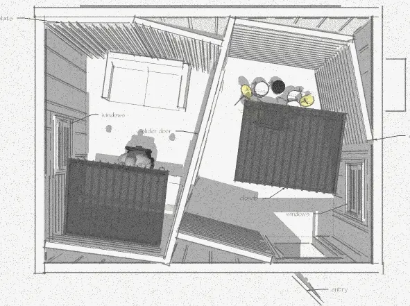

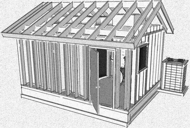

i would go with Bryan's advice on using a single room. if you felt you had to have isolation, then you could either build a vox/drum booth, or split the space on an angle - one side being the CR and one being the "booth/live room". since you're building it with metal frame, you get some benefits in terms of isolation. if you can go with 2 layers of drywall inside all around, it will help quite a bit. remember to plan on your air conditioning/heating/ and fresh air. maybe a couple of window units would work, or you could get your hands on an overhead unit to fit up in the roof area and duct it between rooms...

Yea, I really understand the reasoning behind making it one room, but I guess tracking in that situation would be very different for me. With the exception of here at home, all the studio tracking and mixing has been with full isolation and having the control room able to have monitors running at full volume. Tracking as an engineer into headphones just seems a bit strange.
I like the layout of the attached pictures although it may become a non-issue if things go right over the next couple of weeks. I have a buddy two blocks away from me that has a three car garage behind his house. It had been converted into a two bedroom home and rented out by the previous owners. The city just stepped in and made him tear out all the walls so he has a 20x60 room he's trying to decide what to do with now. With permits they are letting him keep it as a utility room without the garage doors and keep the electical and plumbing in it. (so cut out a 7 ft square for the bathroom) He'd love to make it a studio but depended on the rent income to cover the mortgage. If we can work something out the size of this blank canvas may increase a bit. :)

Aren't the drums going to be louder than control room? So wouldn't it be better to have the main door into the control room? Also, that removes the chance of someone walking in and ruining a recording. ;)

I think what gullfo suggested for two rooms looks really good, as long as the door was into the control room, and not the live.
