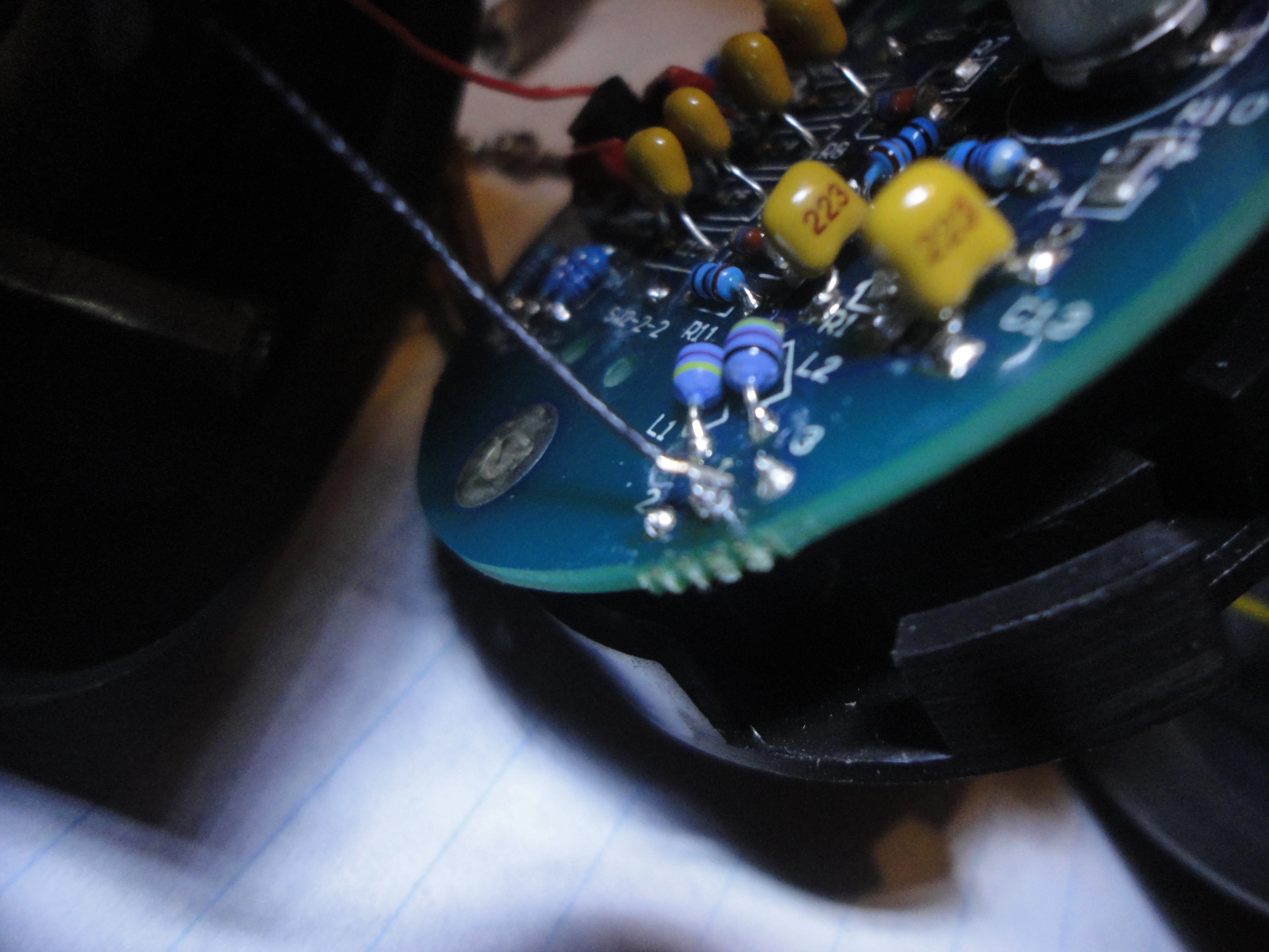

I'll try and get a decent photo that doesn't just look like a fuzzy badly lit circuit board :P
There are two leads (red one black one) and the black one solders to a point which is connected directly to pin 1 on the XLR, so unless the basket itself grounds to the bottom through direct contact or the inner bolts it should be grounded.
I just used my regular soft solder, not sure if it's low melt?

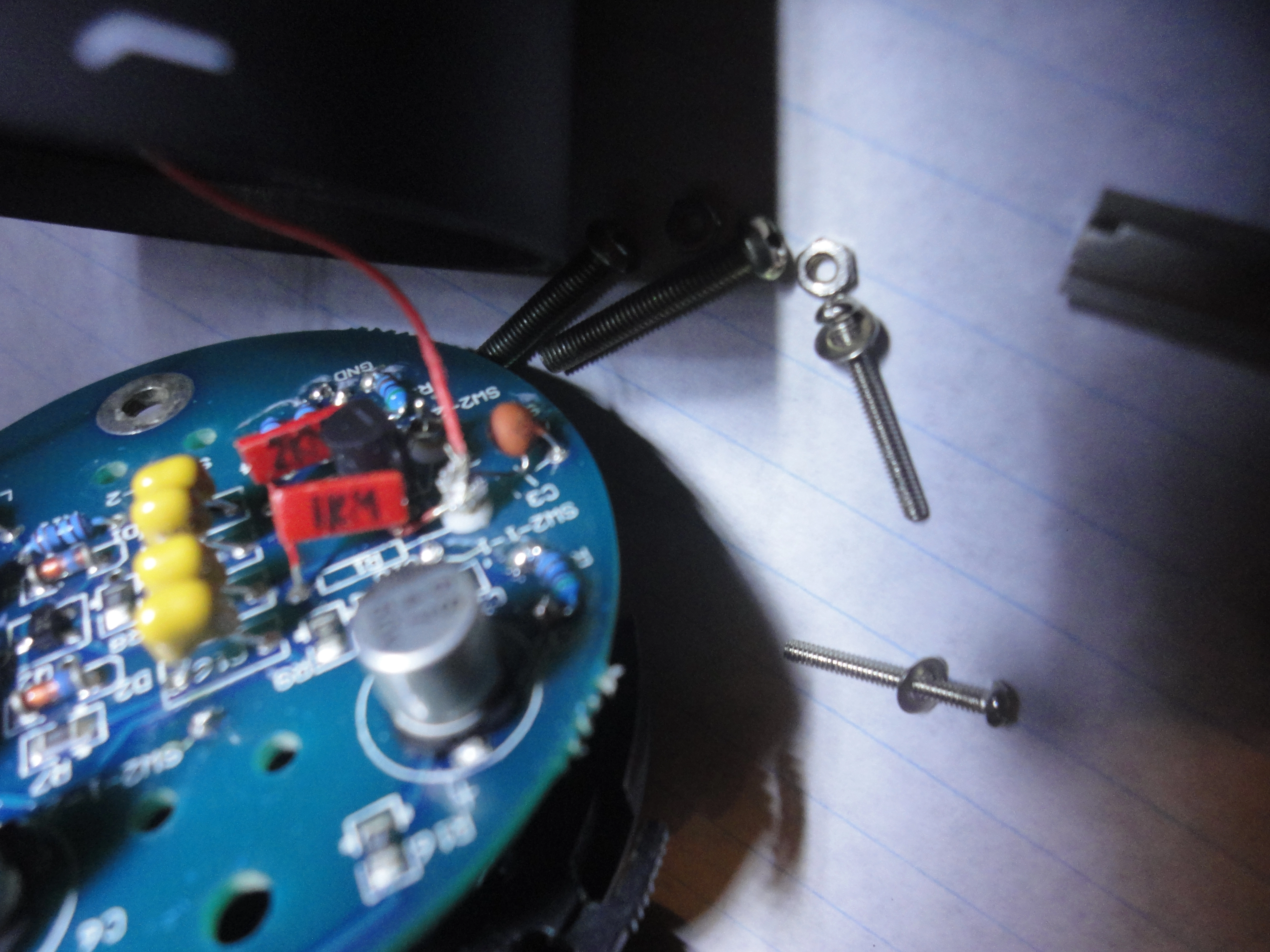

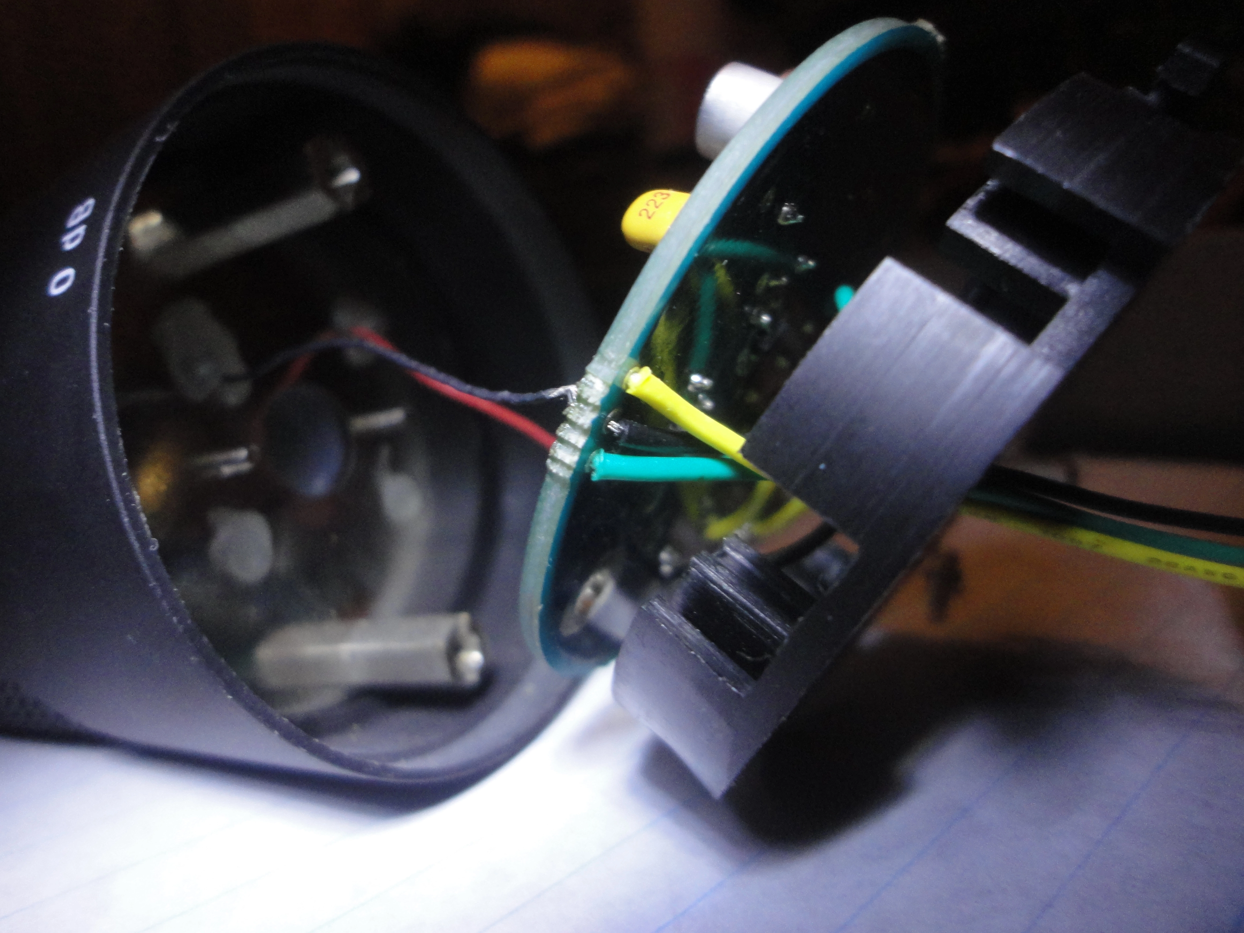

Photos:

Do you know for certain that the wires are meant to go there? I can't find a reference pic online.
The red wire kinda looks suspicious soldered right onto a component leg, but who knows? Maybe that's right.
The solder joints don't look the best to be honest. It could be as simple as that.
I'd check the wiring points and reflow that solder.
Was any damage done at the capsule end? It's hard to imagine pulling those wires straight off the board without doing damage at the other end.

In the pictures your capsule may be grounded, but the cage around it isn't.

I was reasonably certain that the red wire came off that point. Could be wrong, but as for connecting to component leg, I found that on this page (first pic, click to enlarge) ( recordinghacks .com /microphones/M-Audio/Nova )
I've soldered and unsoldered the points a few times with the same results electrically and sonically each time, so I think the points are good (if ratty looking)

Red looks like the right place - the end of the 1 gig resistor, and they have used a teflon stand off for good insulation.
Your soldering looks ragged. Sorry to say it but the solder needs to flow well and make a good clean mechanical joint - practice on some scrap wire if you need to.
Then you need to clean off the solder flux from around the teflon insulator using some isopropyl alcohol on a q-tip aka cotton bud. This point of the circuit is very high impedance, which means that their are comparatively few electrons to do the work. Any leakage pathways can reduce the signal and frequency respsonse, so clean off the flux.
