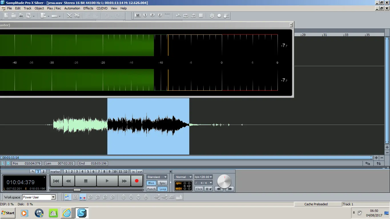

I don't know if that clip got 'boosted' in the MP3 encoding process but it seems to me that the 2i2 gain could be usefully reduced by at least 6dB?
The average level looks to be around -15 to -12dBFS and a peak to -7 or so. The noise floor is a pretty good -70dBFS, knocks spots off a basic tape recorder.
Now, it could be the encoding process or my old lugs but the guitar sounds a touch 'hairy' to me? Tiny bit of fuzzlike distortion? The signal seems cleaner at the end where things are 'fumbling' at a low level.

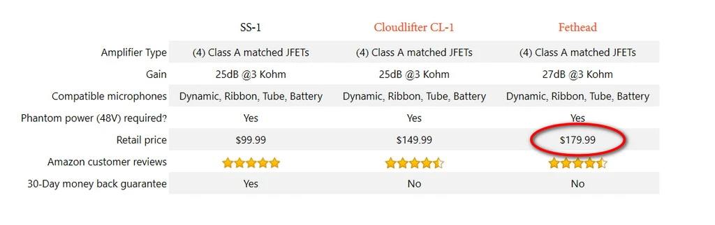

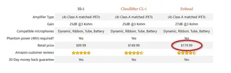

I recently did a review of the Simply Sound SS-1 preamp for AudioXpress. It hasn't appeared yet, but I don't think I'm spoiling much by saying that it's designed for exactly what the OP is looking for- it plugs in between the dynamic mike and the 2i2, runs off the 2i2's phantom power, and gives you about 25 dB of gain boost. It works very, very well.
It would likely help. In your review is there any mention of what the input impedance of the SS-1 is? I didn't see that spec on the manufacturers/sellers site. Both the Cloudlifter and Fethead have a fairly high Zin which does affect the frequency response of a dynamic mic, usually in a good way..
Simply Sound didn't do their research very well comparing prices to the Cloudlifter and Fethead :). I got the Fethead for $99 a few years ago and it's now $89. May have been $129 at one time, but that was as high as I might have ever seen it.
