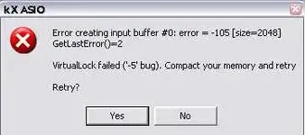

Anyway, I use the kx ASIO drivers with no problem in Fruityloops and in a demo of Cubase SX. I've been happy with them. I tried them in Sonar and all I get are error messages.
Do you have any tips? I am using the latest version of the driver. And, I've installed all the needed SONAR update patches.

Yeah. I patched to 2.2. I can change from WDM to ASIO, but an error message comes up upon re-opening. I believe it is an error message generated by the kx driver and not by SONAR. When I get home tonight, I'll post a screenshot of the error message dialog box.
...hhhmm, it's strange, since I never get this message pop up. I'll check their site regarding this issue..
BTW, do you use any memory management thingee ? Have you tried make an adjusment in the audio options (in SONAR) ?

The new version fixed my ASIO problem. But now my WDM cracks and pops bad below 20ms. The good thing is that the ASIO drivers are a dream, all the way down just under 3ms with minor cracks and pops. 5 - 10ms works extremeley well.
