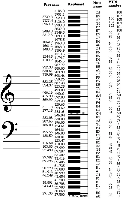

I'm also unsure of the musical pitch to khz equivelance so it's difficult to pick a product that has been rated by nrc for each khz. I play tenor sax by the way.

Here is the answer to your question about frequencies.

Here's a chart per your earlier comment -
http://www.contrabass.com/pages/frequency.html
And those dimensions will work fairly well, there's only a "hole" in bass response around 50 hZ but the lowest normal note on tenor sax per the chart is around 103 hZ (about the middle of that page)

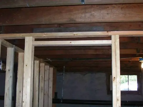

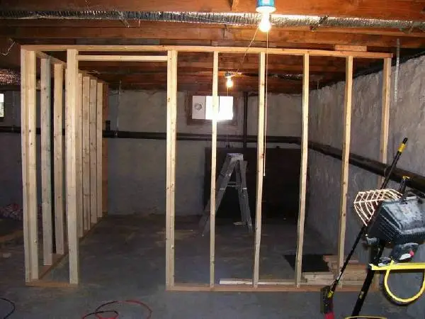

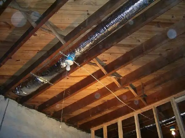

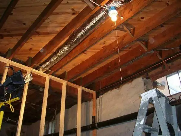

Well, here are the pics. I hope the resolution is good enough to get an idea. That 64kb limit is tuff.
I'm gonna suffer with that a.c. duct overhead but not much I can do about that. The end studs that meet the stone foundation will be filled with morter. The existing wiring will be moved and I'll add some outlets. It looks like I'm going to sister(double) the floor joists overhead to take on the weight of the double drywall. Only 5" of headroom before the top of the door so... I don't think I can suspend seperate ceiling joists. Hope you can offer some insight. Thanks in advance.
Keith

4 inches.. well, you could put 2" deep cut-down 2X4s, 12 spacing, and hang
them with deck hardware.... be a lot of work, but so is sistering the overhead joists. I (in my very, very, limited experience) would bet that hanging the ceiling from your new walls & the foundation walls will beat hat-channeling a ceiling onto the existing (sistered) joists.
are you not doubling the 2 walls you are putting up?

I would stick with my recommendation for two layers of gypsum board on the ceiling and add a recommendation of adding somw unfaced pink fluffy insulation between the joists so that you have a mass-cushion-mass arrangement. I would also recommend making no penetrations in the ceiling. In other words keep that surface mounted light surface mounted.
If you are uncertain about the ability of the joists to take the load make the first layer of the ceiling plywood glued and screwed. That will add strength to the lower web of the joists, essentially making them like I beams.

Did you mean taking 2x4's and ripping them down to 2x2's? I'm not sure, but even with 12" centers it sounds like they would sag quite a bit with 2 layers of drywall. Anyway, even if they would handle it I wouldn't be able to do it. If you look at the corner shot where the oil tank is you'll see the fill pipe and vent pipe exit right at the top of the foundation wall. I would have to make at least the drywall lower than the pipes but that would put it below the top of the door. I appreciate the input but I don't think I could go that route. I would have to rest the frame on top of the foundation wall to clear the door but after looking at it, it looks like the same amount of work as sistering the joists.
As for the walls, I was thinking I'd double drywall the inside and listen to my results. Then, if needed, I would throw up the second wall.
I noticed you nailed one of your walls to your center beam without touching the joists. I did the same thing. Lots of mass in that beam. I think it will still send vibrations upstairs but not nearly as bad if I had connected that wall to a header connected to the joists.
Keith
