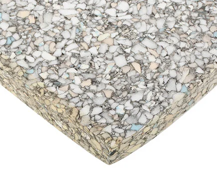

I just bought two panels (Semi-rigid panels of foam agglomerated polyurethane) 2m x 1m x 4cm each.
Specs: http://www.leroymerlin.es/dms/leroyMerlinKit/pdfs/aislamiento/17010994.pdf
Density: 80 kg/m3
Thickness: 4cm
Absorption: 63 db
NRC: 0.81
Do you think this material is good enough to be used in bass traps? If yes, what is the recommended size (if any)? I'm thinking of building eight bass traps 1m x 0.5m.
Density: 80 kg/m3
Thickness: 4cm
Absorption: 63 db
NRC: 0.81

It sure looks like closed cell foam. I do not understand the language on the links but I believe this product is more suited for sound isolation (preventing transfer of sound to another space). Not absorption (controlling sound frequencies within a space). Sound absorption materials need to have sound pass through them yet limit the amount of sound waves passing back through them from reflective surfaces.
I can't say for sure, but I would give a personal 'NO' on using this material for bass traps.
Thank you, Jimmy. So material used should be between reflection and absorption? This material’s NRC index is 0.82 which means it’s highly absorpant.
I am really not the guy you want to talk to about this.
NRC numbers are measurements of a product ability to retard sound from getting through. You need to spend more time researching in regards to 'your' room acoustic treatment needs. I am not about to start a tutorial here. Been there and found treatment that worked for me. None of it involved any type of foam product.
For this thread, I am out.
Spend more time researching the products that work for your particular application.
Cheers
NRC can mean reflective also, which is the opposite of what you want. NRC is about soundproofing, preventing transmission across a barrier. This is a combination of absorbtion and reflection -- the important thing for you to understand is that the harder materials are going to be bouncing everything back into the room and doing nothing.

Wait, NRC values are ratings of the ability to absorb frequencies from moving through it. That is true, but you use of the word 'soundproofing' is possibly confusing points here. Yes the product would have a slight effect on transmission to another room, but not in any way effective unless used with decoupling of rooms. This conversation is about absorption (acoustic treatment within a room) to help with room modes and frequency response within any given room. Absorbing some frequencies from being reflected back into the room.
