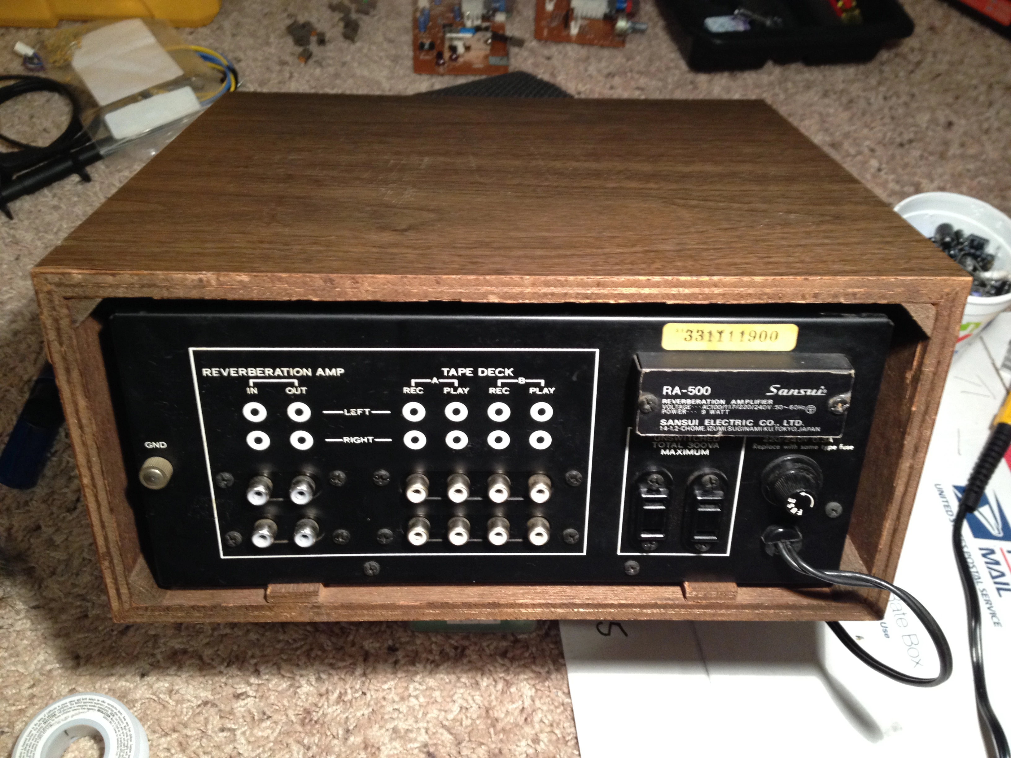

Now the way this thing works is the output is a summation of the wet and dry signals...and the reverb tank takes a mono sum of the stereo input and feeds that to two springs in the tank, so its not a true stereo reverb...but because of the two separate springs the reverb has a nice spread to it, and there is a simple way using the connections on the back to get a 100% wet mono signal out of it. There is also a simple mod that can be done to convert it to 100% wet output only out both L and R outputs. But I'm leaving that alone for now.

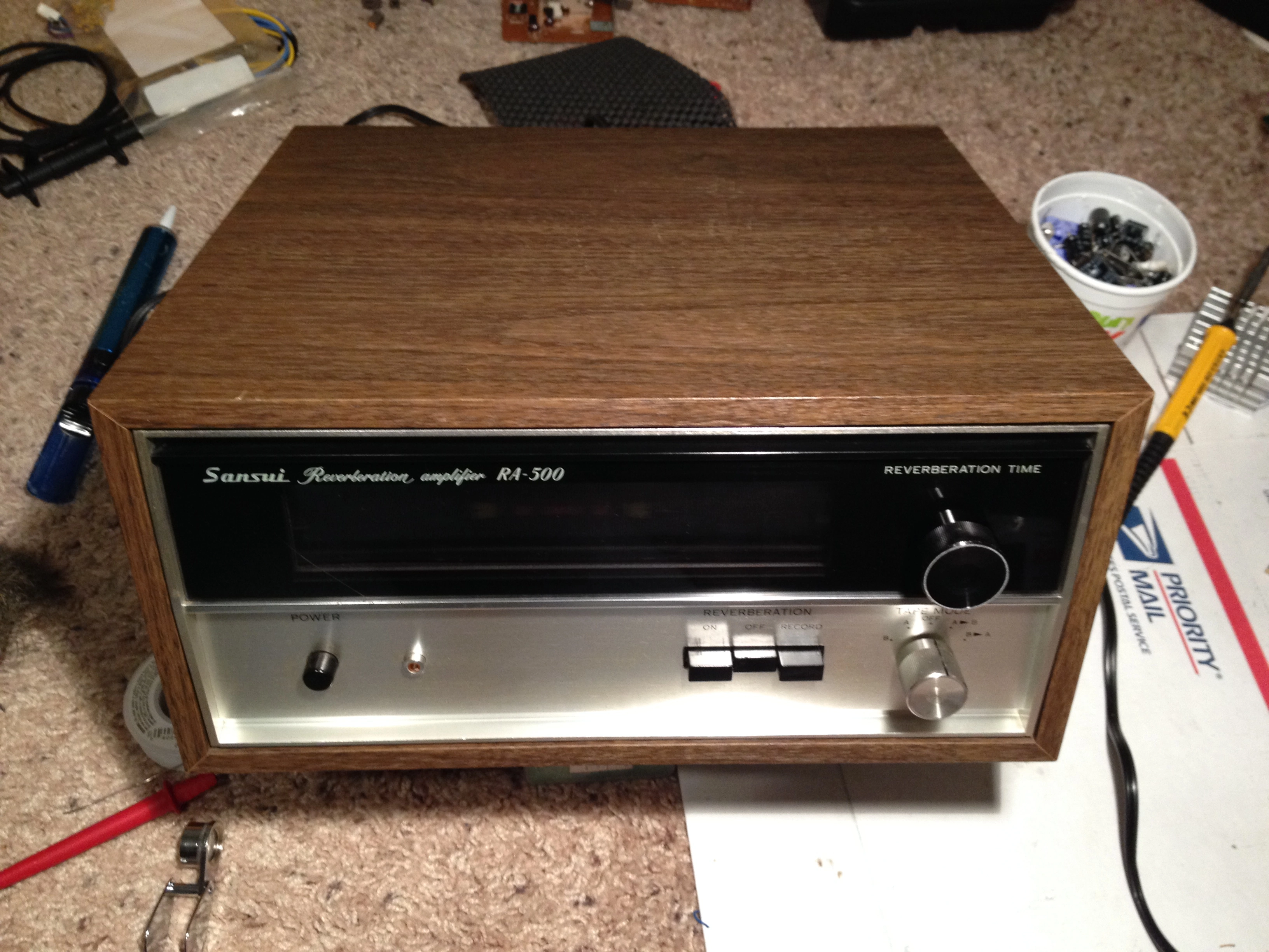

This is what it looks like:

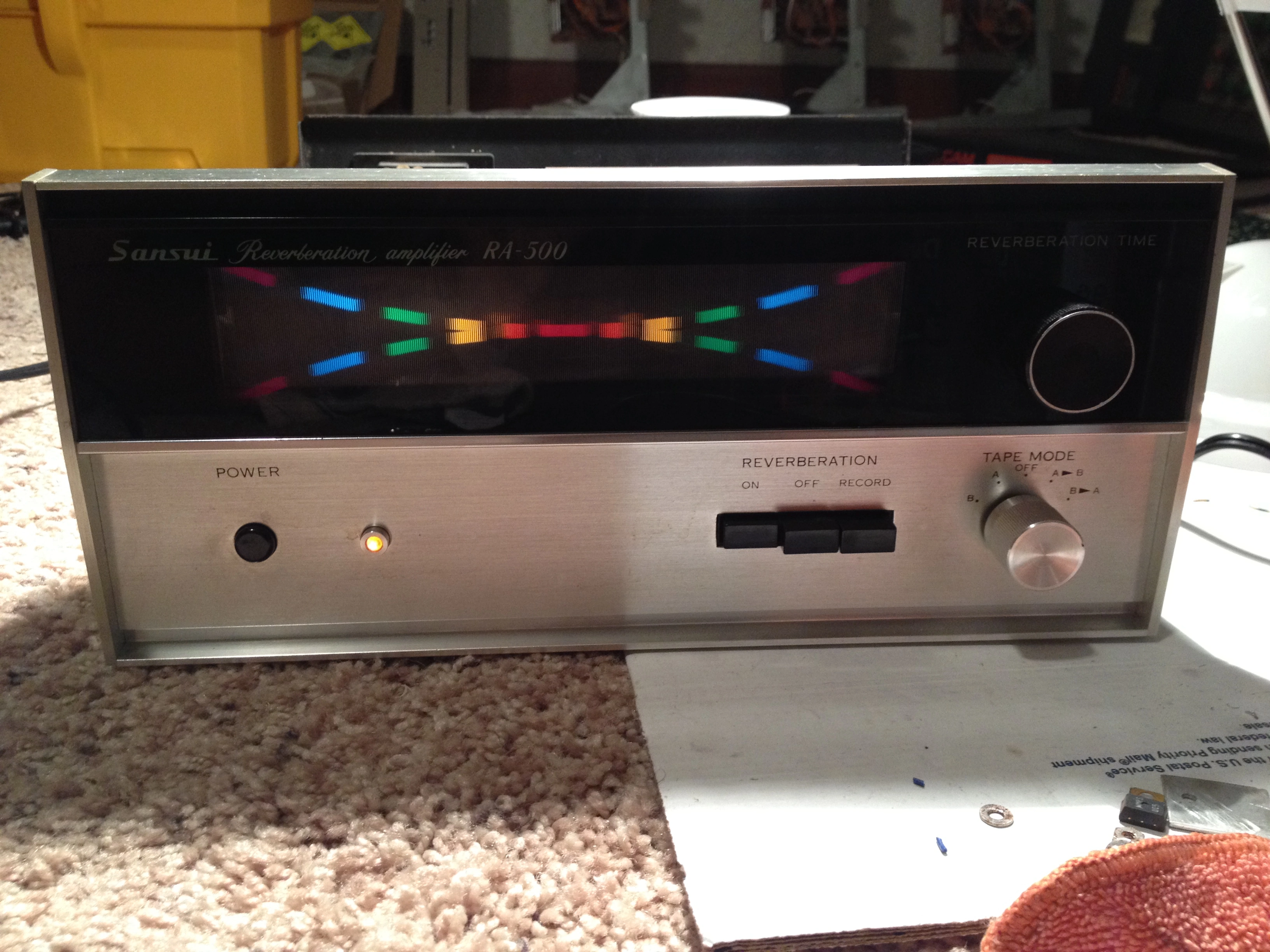

It has a wonderfully 70s "display" to show the status of the reverb level...its actually really ineffective of telling you anything at all but it looks fantastic!
And here's a short YouTube video showing how the display is ganged to the reverb "time" (actually level) control with good old fashioned string and pulleys...and you can see that when the reverb "time" is increased the display becomes...um...blurry...yeah...reverbey...

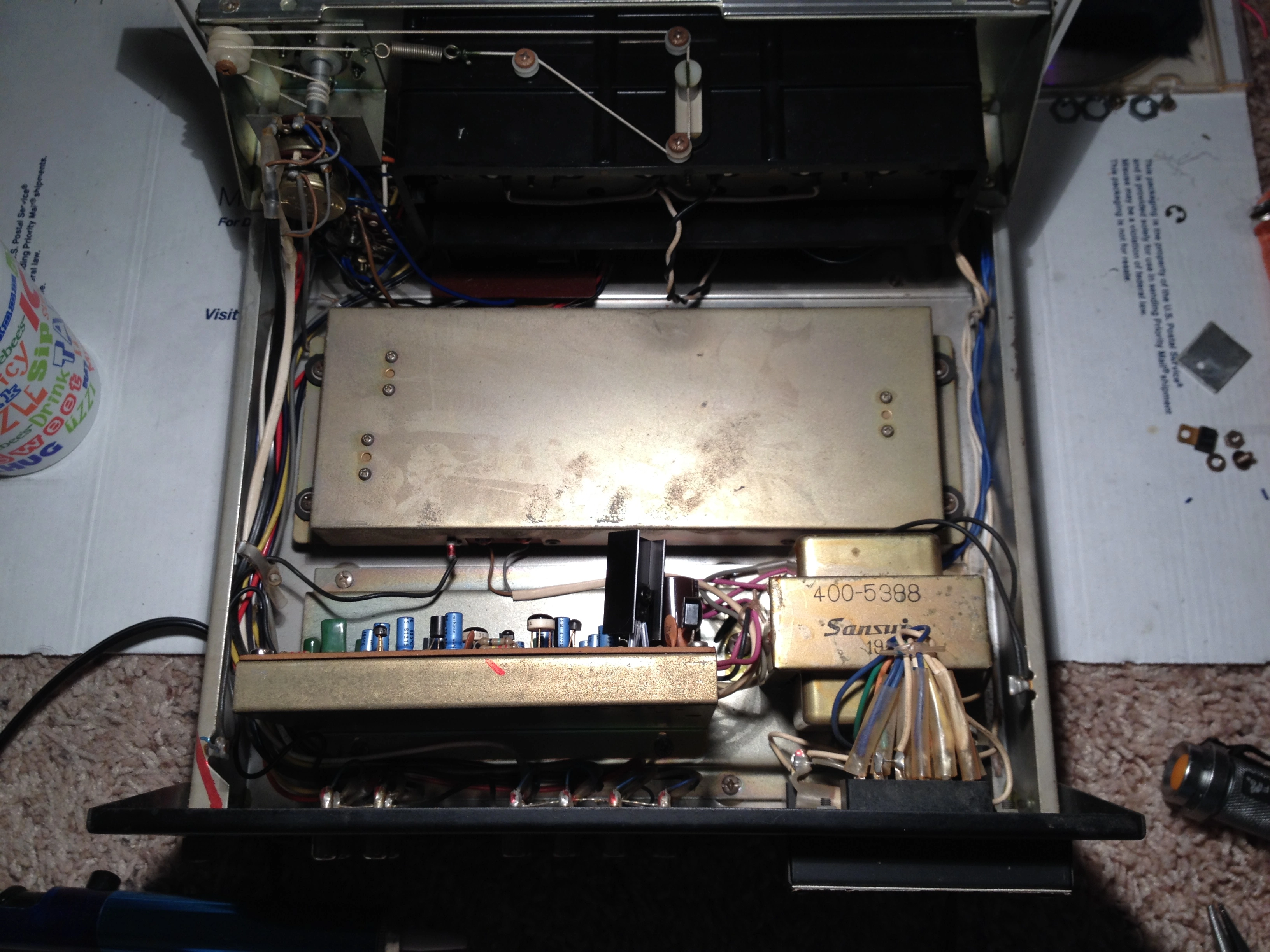

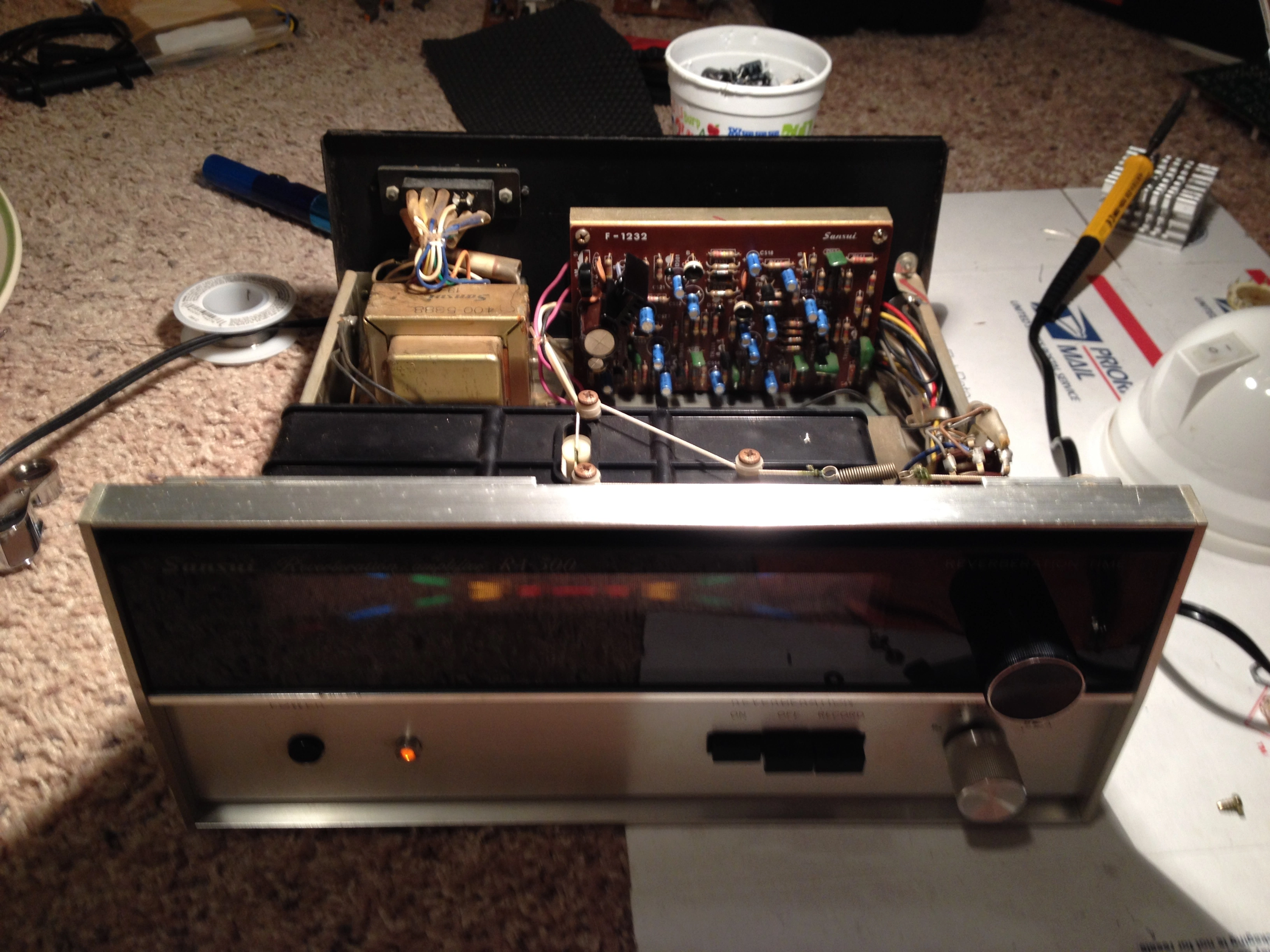

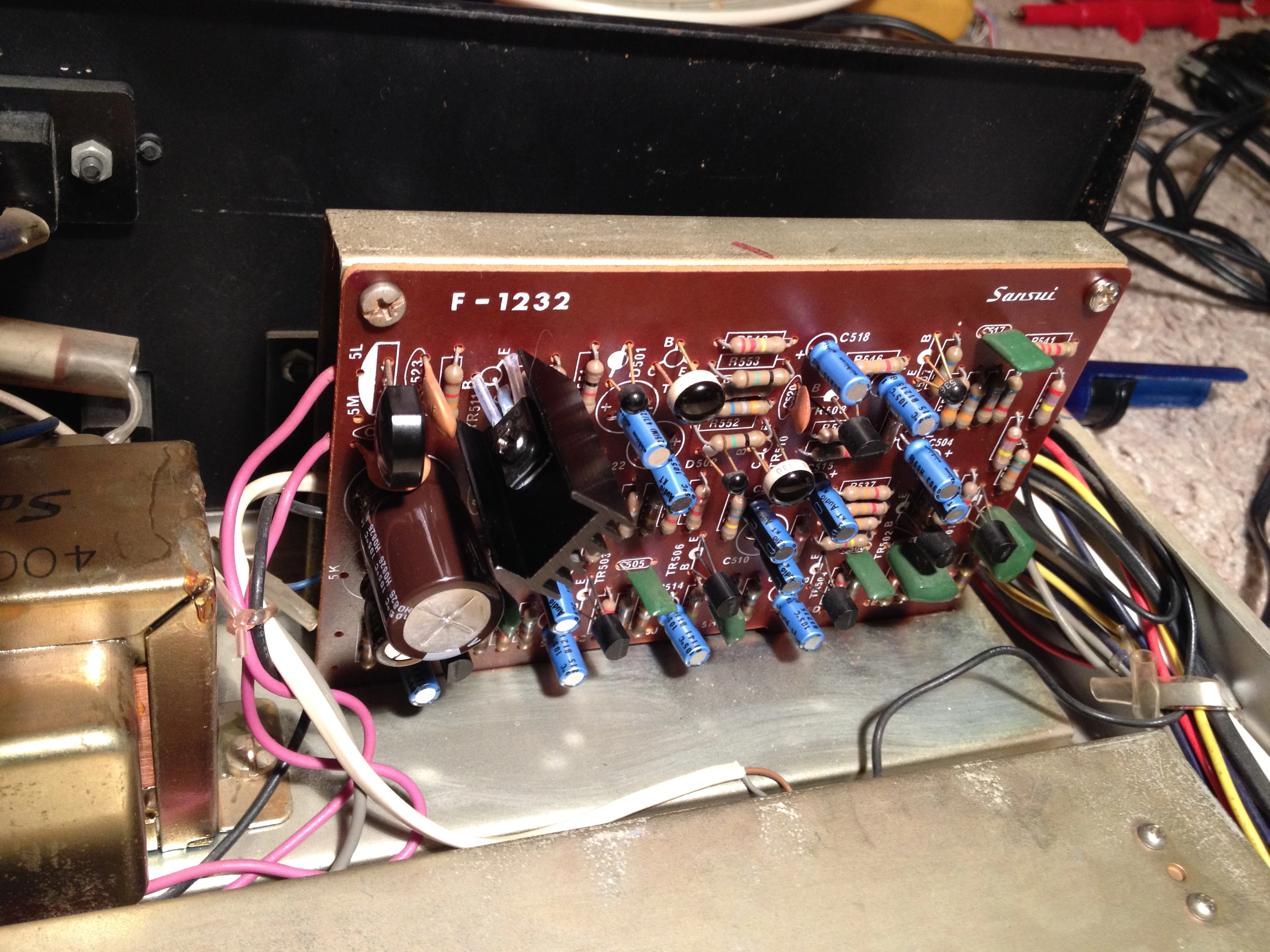

I cleaned it up fairly well (not as in-depth as maybe other projects), serviced the pots and switches, and upon looking at the smallish PCB inside and finding that I had the parts on-hand, I recapped it and replaced the power regulator transistor. The one that was in there was non-original, looked like it was about to fall off, and looked like a makeshift heatsink had been tacked on it...rrrrrreally janky. So I put a more robust part in place with a more proper heatsink though it probably isn't necessary. I put all good quality caps in place and increased the filter capacitance.
Here are some shots of the works:
The neat thing is its 100% discrete.

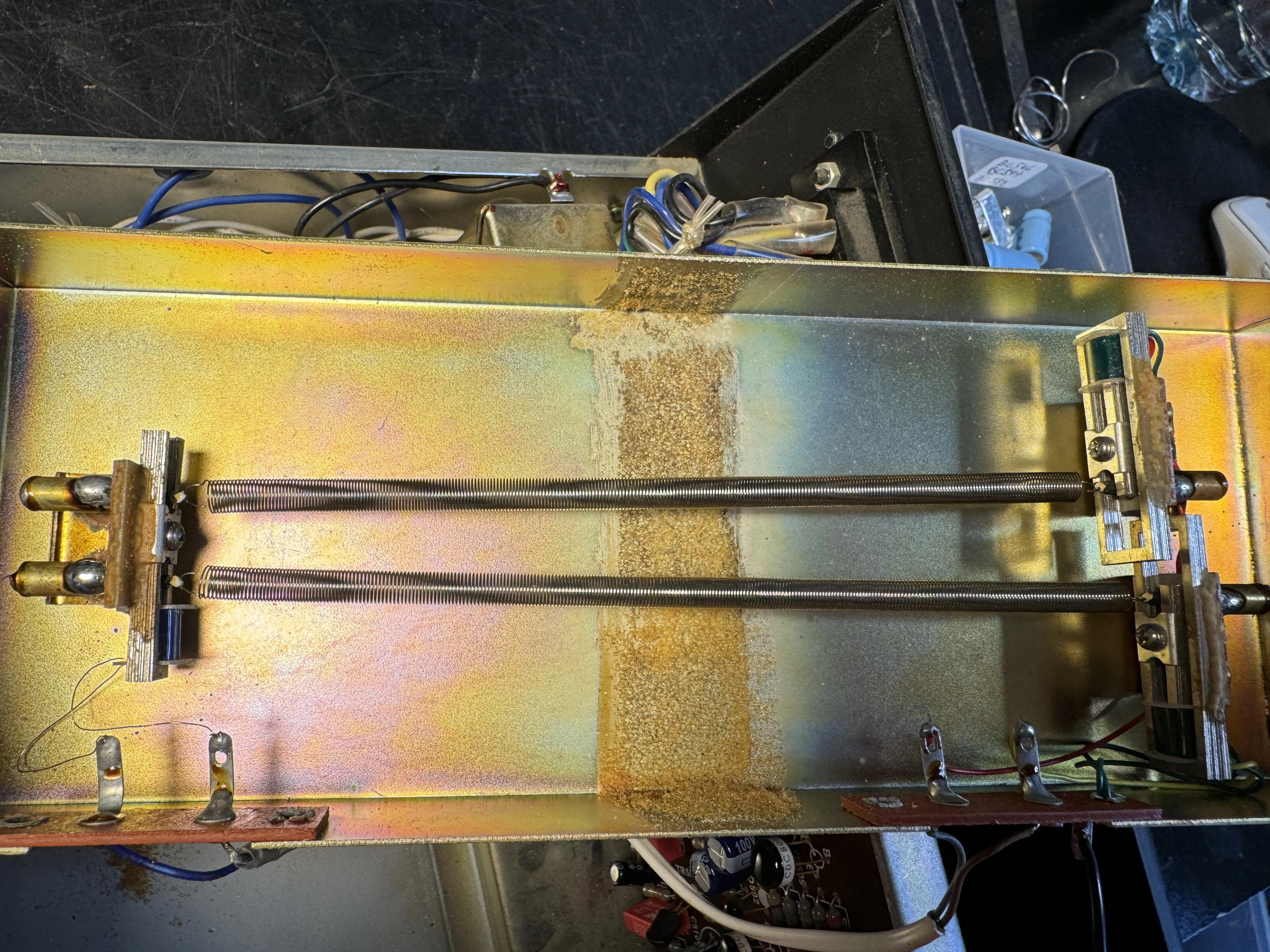

Hi an thanks for your prompt reply, yes al the tank because, I have a slightly relaxed spring which gives an imbalance between Left and Right, do you have photo about the foam buffers inside your tank ?

I sold mine a decade ago. Can you post a pic of yours so we can see what you’re talking about?
If ultimately you need a replacement, I think @BeatleFred has the right idea, you’ll likely need to purchase another complete device.
Hi and many thanks to you, here the pict enclosed.

I can’t tell from the pics what’s “slightly relaxed.” It’s not the tension of the spring that affects the sound, it’s the size and type of spring wire as well as the coil size and number of coils. How do you know this “slightly relaxed” spring is the cause of your imbalance? How did you measure the imbalance?
