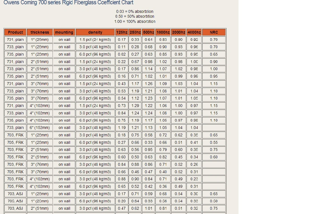

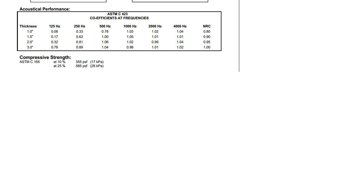

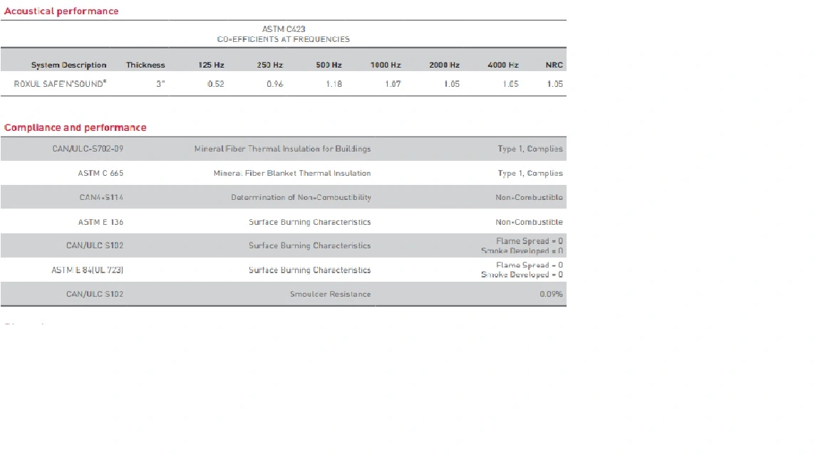

I've been researching the OC703, Roxul RockBoard60 and Roxul SNS materials.
My conclusion is Roxul RB60 is by far and away the best of all 3 for bass traps. OC703 is the best at absorbtion above 250hz. The SNS for frequencies above 250hz is not as good as 703, but better than RB60.
Spec's are below. Absorbtion Coefficient is expressed as a percentage. So spec at 125hz of .90 means 90% is absorbed and 10% is reflected.
The way I'll treat my room is RB60 for bass traps, and 2" or 3" 703 for reflection points.
