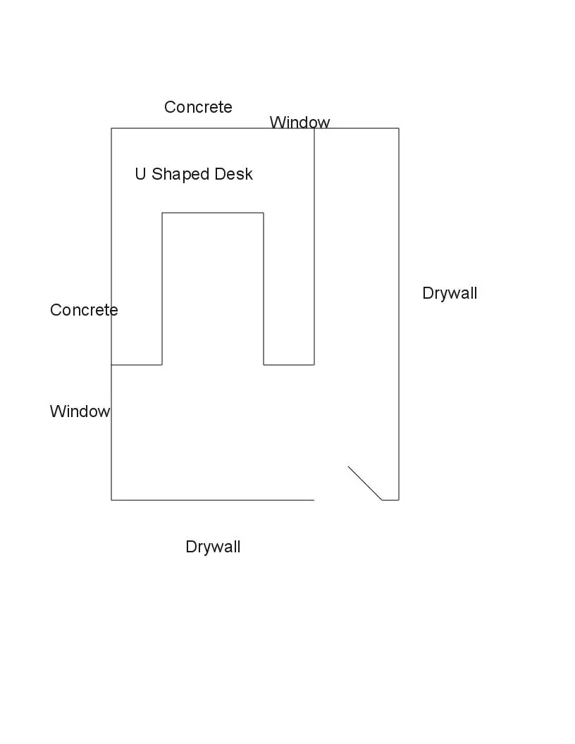

I have a rough drawing of the room and desk (I am not an artist). I did it in OpenOffice Draw so hopefully this will work. I will try to attach it
Here is the pic I drew. I can live with the 2 concrete walls, but I think I will haver to build at least 2 more inside. For sure one behind because that wall holds all of my CDs (over 2000 of them). I basically want to enclose my desk.

Brian,
I would have to see actual pictures or detailed drawings of the current windows to accurately suggest anything for you.
I would suggest that you center your desk set-up between the walls... :D
-- John
Brian,
-- John
That is why I wanted to add the extra walls on the right side and the back.
Every voice over studio I have been i has been small, usually big enough for 1-2 people at the most. Lack of space doesn't concern me.
OOhh, I C.
Well, If you don't mind tiny. Go for it. You will have to treat it well.
Thick trapping in the corners & at least 2" OC703 on most of the walls.
Do you have room in the window area to build a frame inside the window opening? -- build a frame that sets back 1 1/4" from the wall so that you can apply 2 layers of 5/8" gypsum board after putting in insulation with the frk facing the room. Then seal well with a butyl rubber caulk or other acoustic rated caulk.
