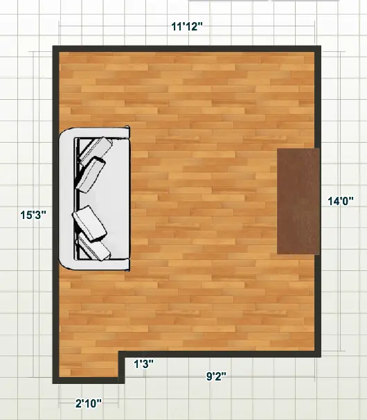

I've been working on slowly gathering enough gear to start working on some tracking for an album and recently purchased the Auralex Alpha-DST Roominators Kit to see if it can help with some reflections. My room is somewhat quirky (dimensions below) but there aren't huge issues that I've noticed.

Room dimensions:
The ceiling splits in the middle with the one closest to the door being 81 inches high and the one on the other side being 84 inches high. There are two windows (they fold open, used in most older basements) one over the desk and one on the far side of the room (not near the door) that go 7 in deep. There is also some sort of plaster/drywall boxes that seem to cover some piping on the wall with the desk that are 9inches in length and 6 inches high.
The floor is concrete which I have a very light rug (maybe a few centimeters thick) and the walls are plaster/drywall except on the wall parallel to the door which seems to be concrete/bricks.
I hope I've given enough information and if anyone could help point me in the right direction as far as where to place these panels it would be a huge help.
Your desk should definitely go against the wall that's 11'12" long, not along the longer wall. Wait, isn't 11'12" also known as 12'?

I haven't moved the desk position because there is a radiator on the wall that is not next to the door. It might be possible to move the desk to the wall near the door. Would that cause any problems?
