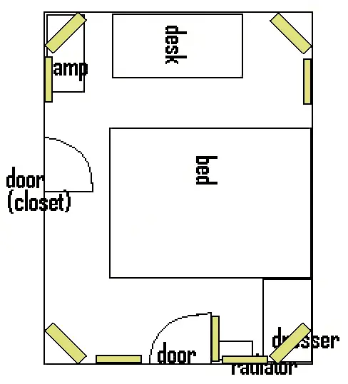

However, I'm still working in what's essentially an un-modified bedroom. I've got my desk in one corner with my monitors wall-mounted above it, my amp on the other wall, my bed (lengthwise) in the opposite corner, and a dressor across from the bed. I'm right next to the roof so the wall over my bed slants up to the ceiling a bit. I've got my guitars wall-mounted over my bed, and a few picture frames on the walls, but that's it. Layout is approximately as follows:
attachment.php

Is this picture to scale? Does your bed take up almost half the room?
This is my suggestion from an acoustics perspective: Build/buy 4 gobo panels(movable rigid fiberglass panels) for placing around the amp, acoustic guitar or drumkit. Maybe you could mic up the drumkit with gobo around panels in your flatmates room, the hall, living room, kitchen, or whereever, which would give you some isolation from the "control room". Definitely get out of that corner and get symetrical with speakers firing down the long room dimention. The absorpton panels I'm suggesting 2'x4'x2-4"(2" for flat wall, gobo and ceiling above mixing position, and 4" for across corner bass traps) rigid fiberglass panels, framed and wrapped in fabric, can be hung like a picture, and could actually be painted or covered in a nice fabric, so you can either just take them down when you have a girl over, or they could look quite decorative.

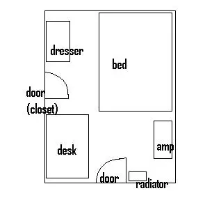

Hmm. I'll bust out the tape measure tonight after work and get something for you that's approximately to scale.
The short answer is, it's probably not feasible to make the sort of changes you're proposing. When positioned perpendicular to the longer axis of the room, I believe I have 2-3' to spare between the wall and the end of the bed, which is 1.) awfully tight, and 2.) will interfere with (i believe) the range of motion for at least one if not both of my doors.
I'll provide better measurements tonight, as well as experiment with reorganising.
I TOLD you Boston was tight, lol.
Did some work over the last couple days - really there's only two feasible layouts for my room, the bed as it is, and the bed against the back wall pointing perpendicular to the axis of the room, and neither of them would give the desired layout.
The best I could do would maybe be to wall-mount my monitors on either side of the door, facing into the middle of the room, and just listen to the playback a foot or two away from my desk. Not ideal, but better than nothing, I guess...
