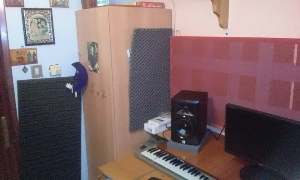

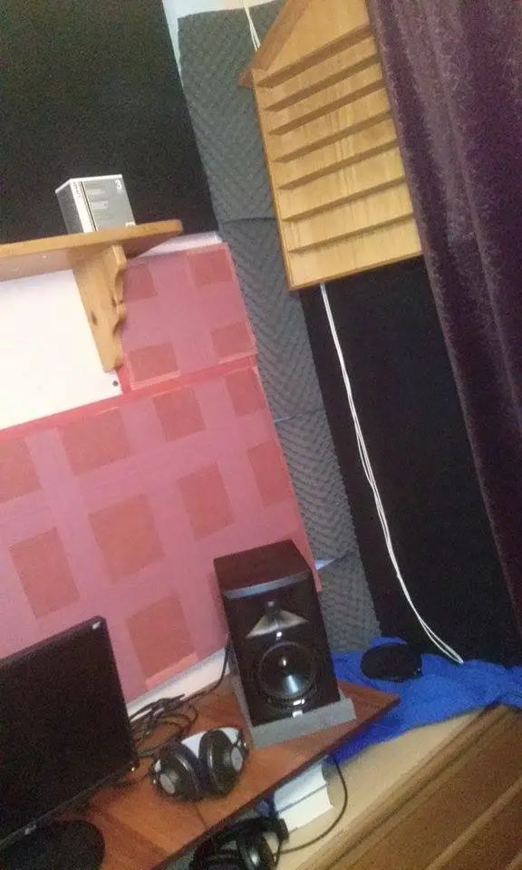

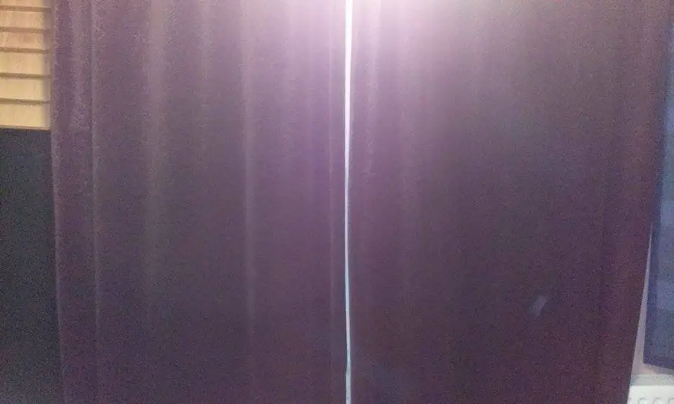

Its the mix position..where is see the spekers and the screen..Right are the thick velvet curtains

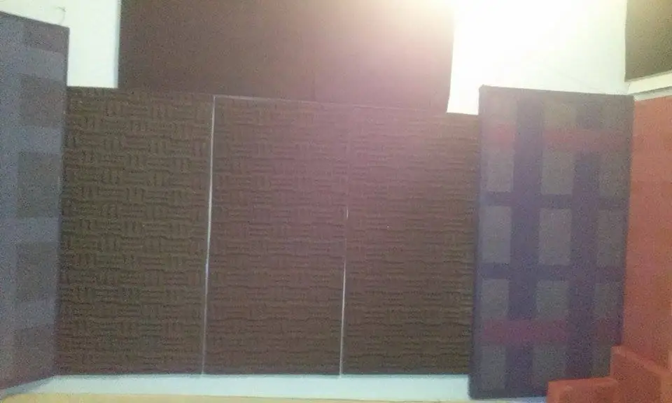

Behind me are the panels on the wall..And bass traps made from rockwool and fabic

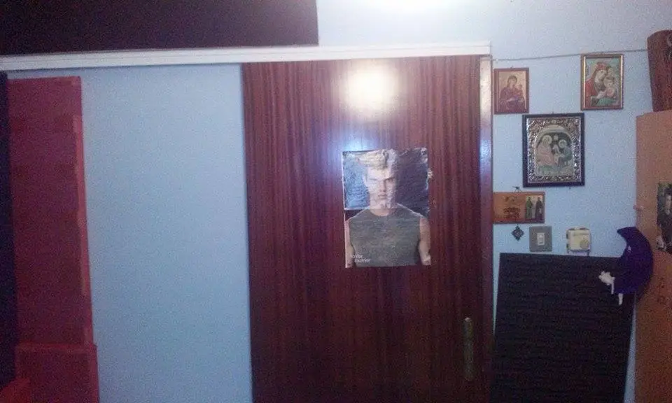

Left from me is the door and a panel

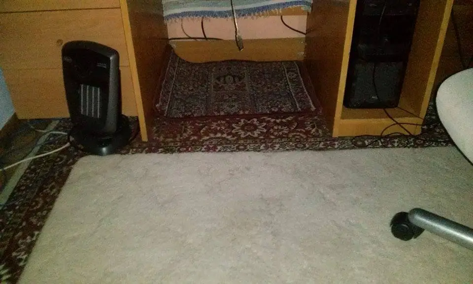

In the floor two carpets..The first is not too thick and the other has somehow its not like the norma carpets

It looks like you have put up a bunch of foam on all the walls (are any of those panels rockwool?) Foam will absorb some of the highs, but none of the low-mids or lows, leaving you with boxy sound and uncontrolled bass issues (which are not so much a problem if you're only tracking vocals, but can be a problem when mixing).
On top of that, your room is almost a perfect cube, which is bad due to standing wave nodes. Get rid of some/all of the foam and build/buy some 4" thick (minimum) rockwool bass traps.

Hard to tell with the photos.. is #2 the back wall? Maybe pull the high one and the two L/R panels (keep the center).
Basically shoot for enough thin panels to tame flutter between opposing walls. Stack them in a corner? (more deep/low control, less highs and surface covered.
