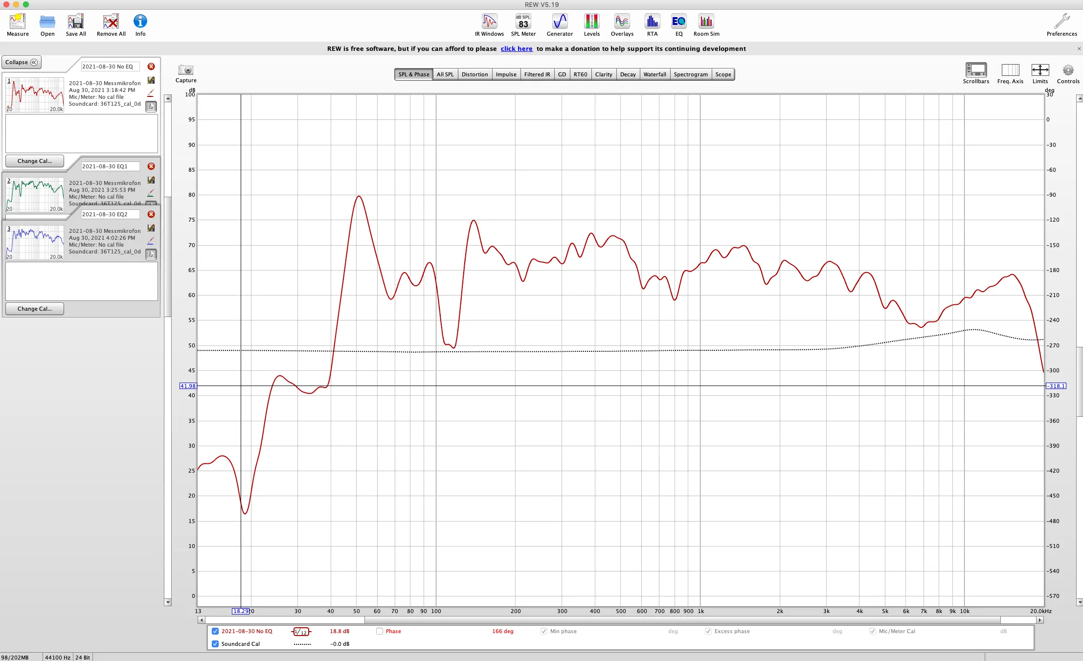

I recently measured my Room and as you can see, the results are not so good...
The main issues in my opinion are the modes at 50 Hz and the gap at 114 Hz. Do you have any ideas to solve these? I know that the mode at 50 Hz is not easy to deal with.
Because I don't have to deal with deep frequencies most of the time, the Gap at 114 Hz bothers me the most... Is there a possibility to solve this (maybe just a bit) by putting the output signal of my RME through an external EQ?
I hope to get some helpful answers..

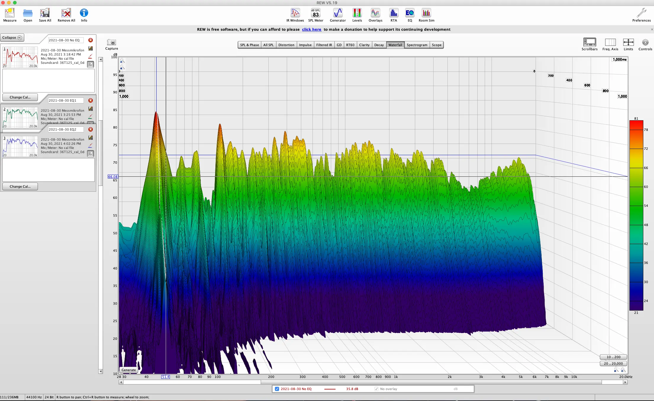

Eqing it won't work. You need acoustic treatment to absorb the sound so it doesn't bounce around and create the modes.
If you search for bass traps that employ Owen's corning 703 insulation panels, you will find info on how to build them or buy them pre built.
Don't bother with foam bass traps, they don't work well at the frequencies you are having problems with.
Definitely this!
One other thing you can do is experiment with speaker placement and your listening position within your room. Take the whole equilateral triangle and move it closer or farther away from the wall and see how it sounds. You can really flatten out some of those nodes/nulls by simply moving your speakers and yourself within the room. Doing this plus trapping your corners and points of first reflection with broadband traps will go a long ways towards flattening out your monitoring environment.
That is true. If you happen to be sitting in the middle of a node, just moving 6 inches in any direction will help, or at least change what you are hearing.
Remember, that room measurement is only measuring what is happening at the exact place you put the microphone. If you move the microphone, the graph will look different. So you want to put the mic right where you head will be when you are listening to the monitors. As Tadpui suggests, moving your listening position can help, but broadband traps will actually make the room better.

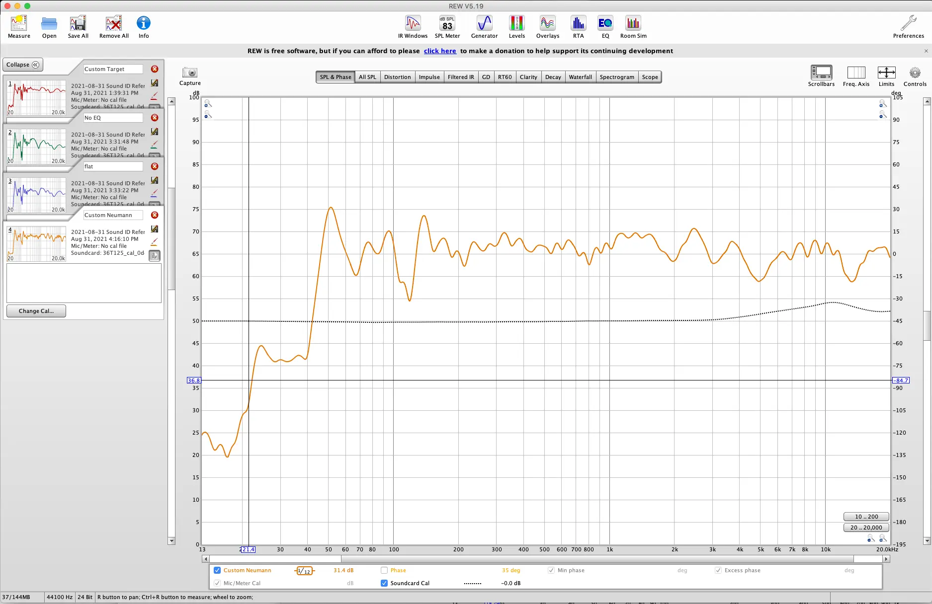

Here is the improved curve:
