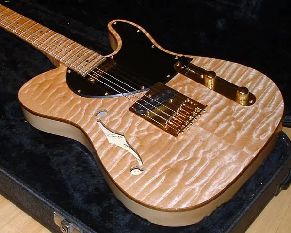

If you want a build thread I'd be happy to help you out.. I recently finished a couple of tele' style guitars and because I rarely do them I took a bunch of pics. I also had to make a load of jigs as I haven't done any fender style guitars in a long while as nearly all I do is archtops and the odd acoustic these days. It was a hell of a lot of fun and was pretty much built without breaking down my normal machines and work methods, so on the bench with a router and jigs etc.
It's at the photographers right now as I finished it last month but I did snap a few for the customer before it went.
If your confident you have the time and a reasonable skill level it can be very rewarding and you'll end up with a guitar that is infinitely better than the ones your looking at.

That's a beautiful guitar, except for that f-hole cut in the top. It looks like a gap and unfinished wood underneath. What's with that? (Or maybe it's just the pic.)

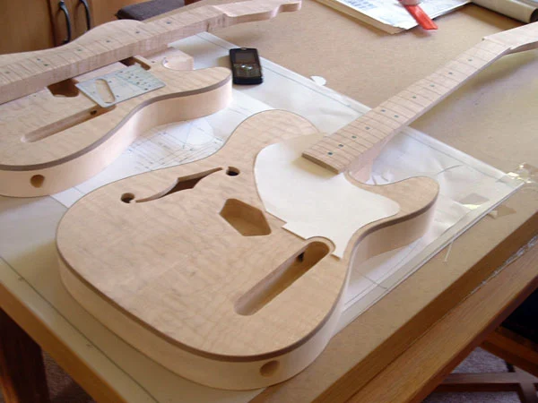

The pic doesn't really do the f hole justice I agree. The body is chambred and the f hole is cut in the same place as a standard thinline. It's lost in the picture. It's not my design but it's what the customer wanted. I actually quite like it now it's done. It's based on an old epi design. The colour inside is the label. Better pic of the f hole outline attached when it was still in the white.
A body of 1 3/8ths is going to be tight unless you use a cap for the top.
