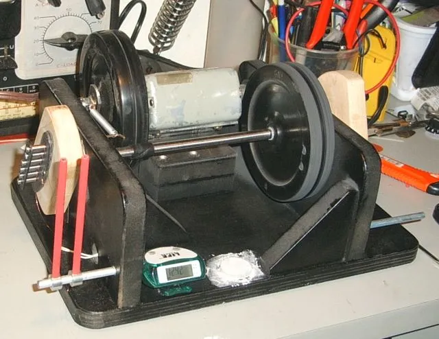

Sorry didn't realise that was you and I wasn't critising just being hungry for more detail. Nice one I'd like to talk methods sometime if thats OK with you. Particularly interested in your winding setup. I've been meaning to jig up another setup soon. Mine is a bit old now and I'd like to get a better method of counting the wraps. How do you do it? Got any pics of how your doing it?
No apology needed. I'd be happy to share technique with you at any time.
I built the winder out of normal hardware store stuff for less than thirty dollars. It's my own design. The wheel on the right is directly driven at a 5:1 ratio by the motor. The wheel on the left is for the counter. It's driven by the mainshaft at a 10:1 ratio for the counter. It's a decade counter that counts every tenth turn. This allowed me to use a cheap reed switch that isn't very reliable at high speeds. The counter itself is a cheap pedometer that I wired to the switch. The maximum RPM is about 2,500 although The fastest I wind is about half that. I control the speed with my variac.
