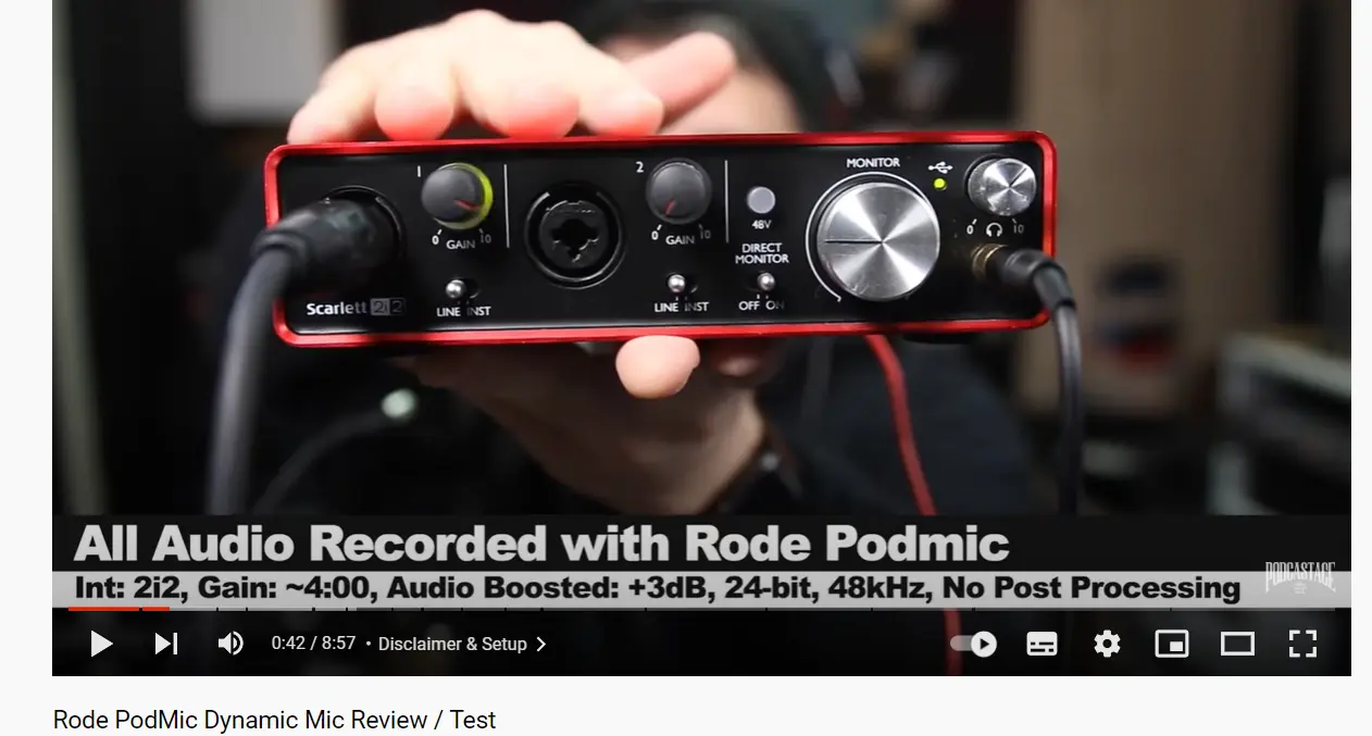

So I saw this video using the excatly the same set i did, but instead of the crystal clear voice, mine sounds a bit blur and have huge static noise
(2) Rode PodMic Dynamic Mic Review _ Test - YouTube - Google Chrome 2022_4_16 上午 02_22_07.webp

Well, it's a dynamic mic and the gain is cranked up pretty high (in Podcastage's picture, at least), so it could be partly background noise in your environment. It's an "end-address" mic so make sure you are talking directly into the end of the mic, and not on the side, like you might use a condenser mic.
