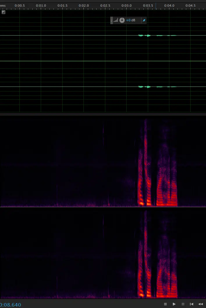

To be honest I'm not entirely certain. I'm about 10 mins away from my house, i'll definitely give it a try as soon as I get home. My headphones are typically plugged into the monitor I have a Mac so I just plug it into the back what I do is I record in my closet through my macbook then I airdrop it to my desktop my mac and that's where I begin editing. So I've listen to the noise in both my MacBook as well as my desktop Mac.
Okay just listened to it through headphones in the interface and noise is there.
Here is a pic...the sound is visual as well. So I don't attribute it to my speakers or headphones.

Now this may sound a little weird lol....but I took my test clip, captured noise & noise reduced it 3 times. Then each section of speech I highlighted and normalized to -5db. Surprisingly the hiss isn't there and there is no echo/tin/internet voice effect..... while this was only done on a small clip I wonder how this type of editing could work on a 30 min audio clip. Oh boy...at this point I can give that a try....until a better option pokes its head.

What happens when you record louder? Get your peaks up to about -6dbfs or so. This will test whether the hiss is part of the mic/preamp combo or inherent to the interface. If the hiss stays the same, it will be 10db quieter compared to the voiceover.
lol anddddddd I spoke to soon. Bah! I get that internet sound in certain portions. Just tried it on a longer section.
Getting my voice up there drowns it out during speech, but the minute I back down for a split of a second Its present. It reminds me of a low AOL dial up sound...not full on, but like its part of that annoying sound lol...or maybe my ears are just so sick of hearing it lol
