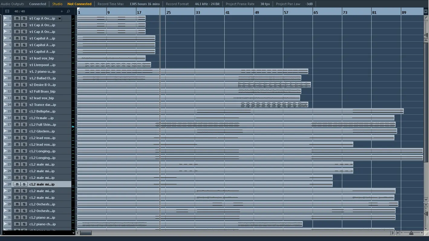

I came late to the party. Some really good unique stuff here. I agree with most of what Chili said as well as some other comments. I am not sure I would have a realistic judgment of the mix without hearing the main vocal part where it needs to be. Other than simple advice of compression and eq, I couldn't really say exactly what I would do without the track in front of me.
That being said, well... If interested I would love to play with the tracks myself. I love a unique challenge. :)
Here is the track screenshot. Send me a PM with your email addy...

Ok, I played with it for a bit.
When I first opened it up I said '39 tracks!?!?!'. WTF?
But then I later realized why.
I took a bit of a different approach here. Not sure if you will like it Jessica, but it was fun. :) I learned from it as well.
