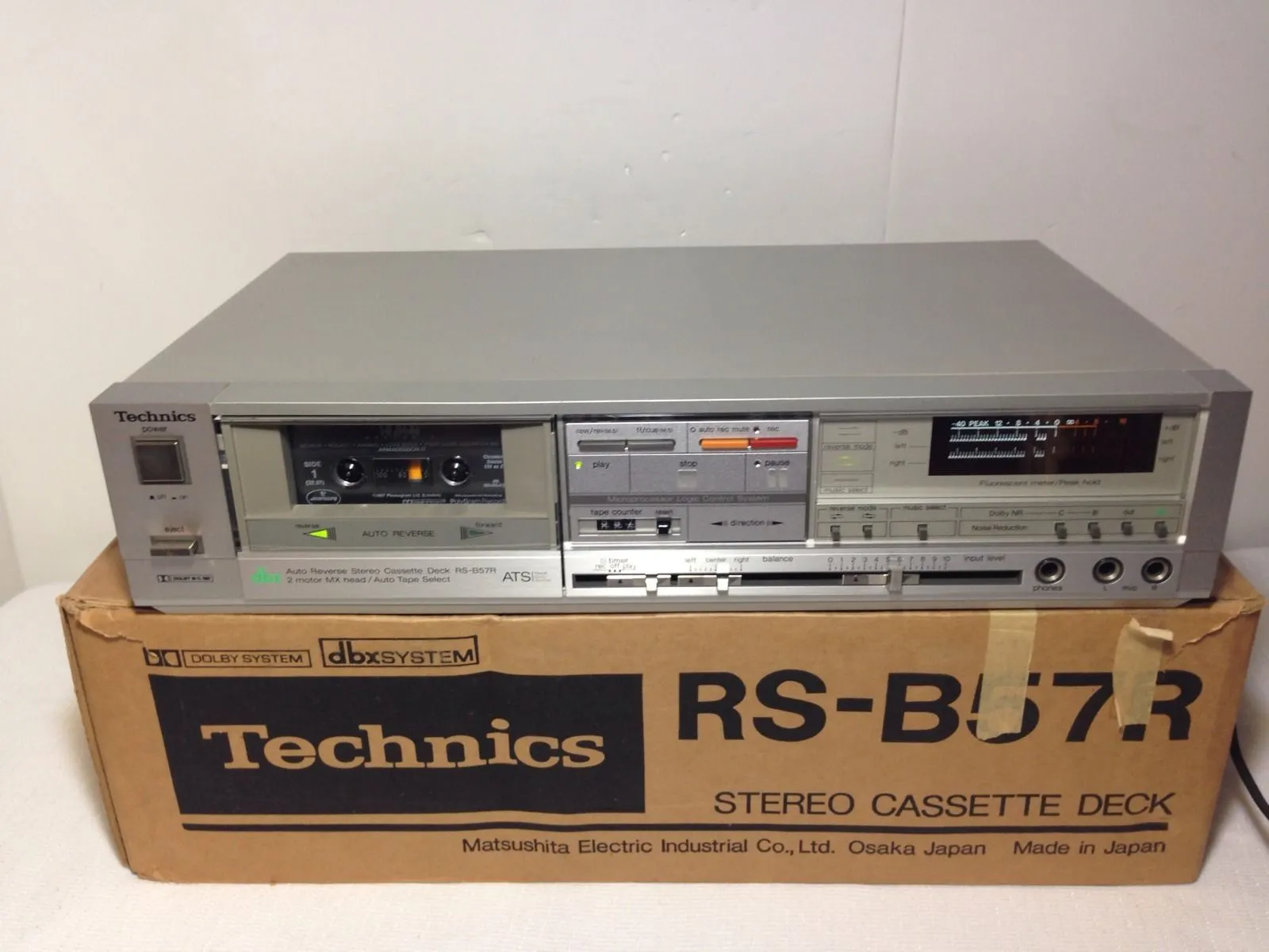

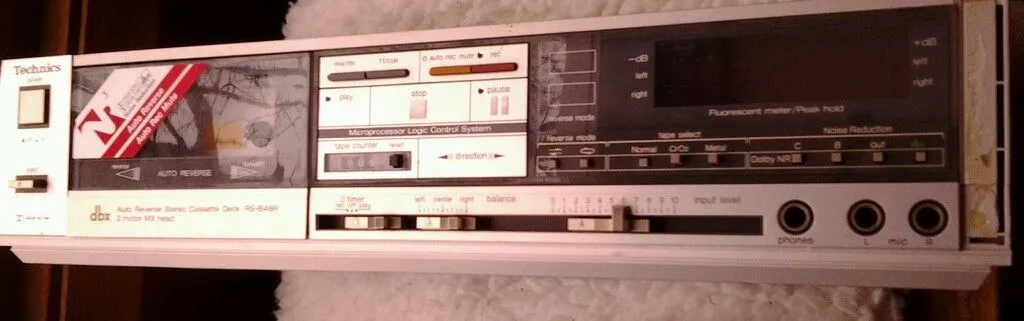

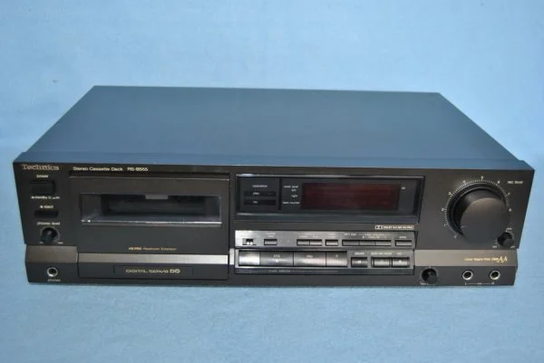

Thanks, I want to record some live audio onto cassette tape, but most decks come without mics, and many didn't have mic sockets anyway. Obviously I want the best cassette audio I can get so I will have to match the mic (impedance) pretty accurately to the deck i get - probably a retro JVC.

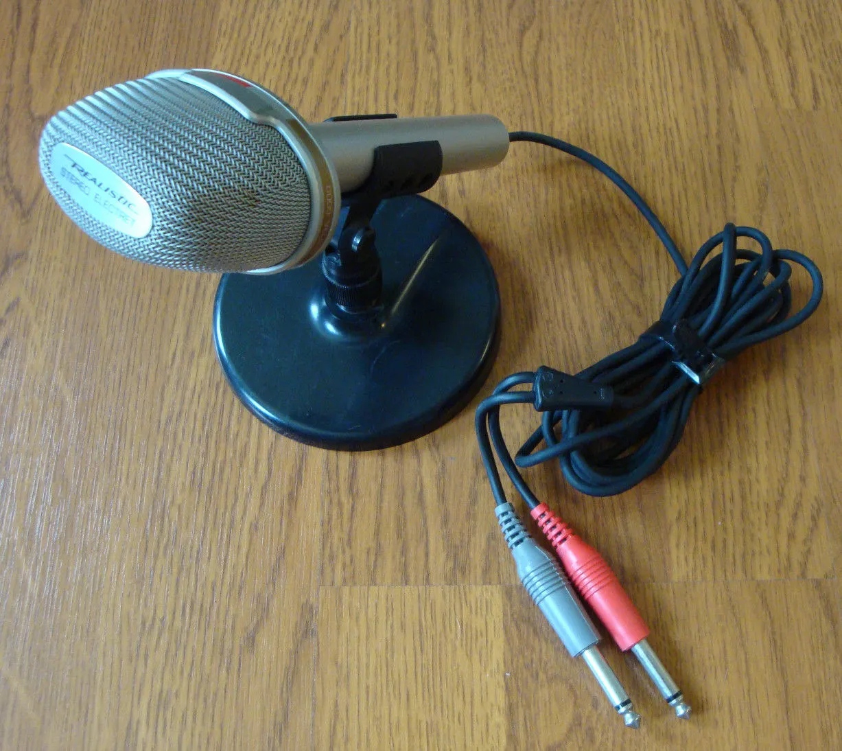

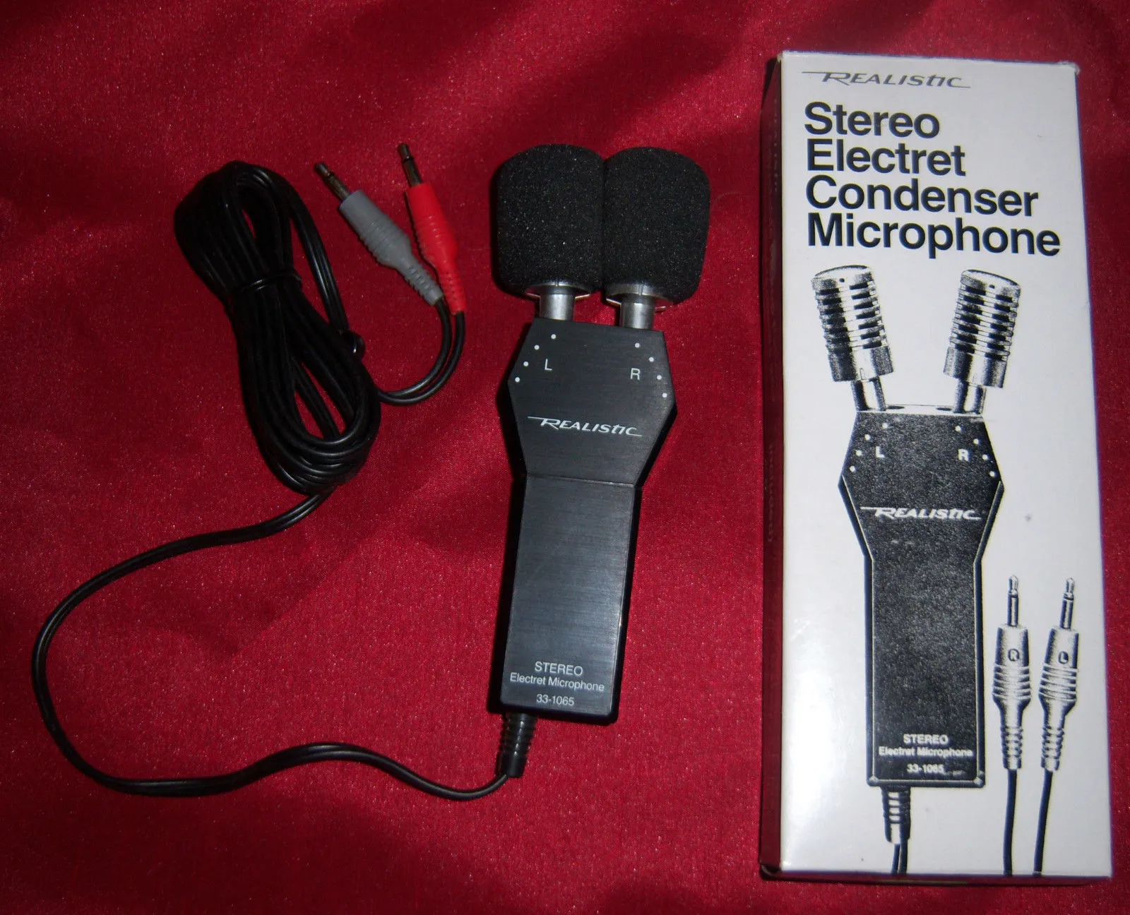

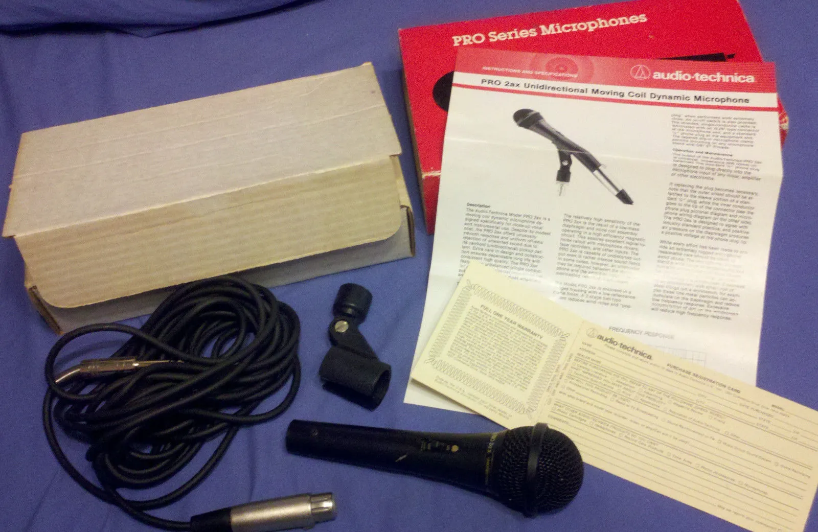

Most likely any of those mics will work on most any of those machines.

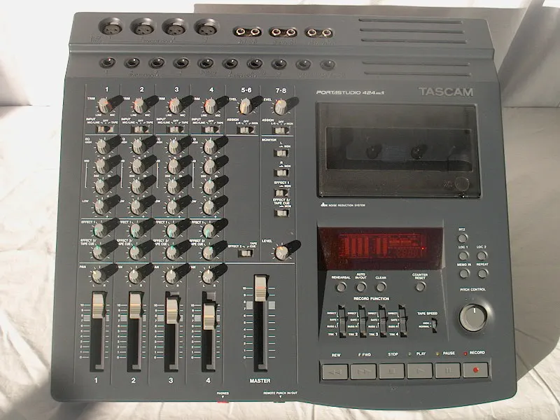

Thanks. I may go in for a 4 track cassette 'portastudio' - because this will give me more recording latitude - i wonder if those stereo mics will work with those as well please?

The jap kit of that era used unbalanced medium impedance mics, exactly the same as all the common ones today. So any dynamic with pins 1 and 3 shorted with audio to the tip from pin 2 will work fine. My very first sm58 worked fine on my technics cassette.
Thanks, wouldn't it just be easier to source some unbalanced medium impedance mics on the Bay though - or are the modifications you suggest fairly straightforward?
Low impedance source into high impedance load tends to work fine. I wouldn't worry too much about it unless you try something and it clearly doesn't work. The modification he's talking about is just how the cable is built, not something you do to the mic: XLR-F to TS, with pin 2 to tip and pin 1 and pin 3 to sleeve.

That silver Realistic mic works quite well. I have two of them, I haven't used them in years, but I used to record all band rehearsals and shows with them. I also used to use that mic and a kick mic for recording drums. Great stereo mic.
