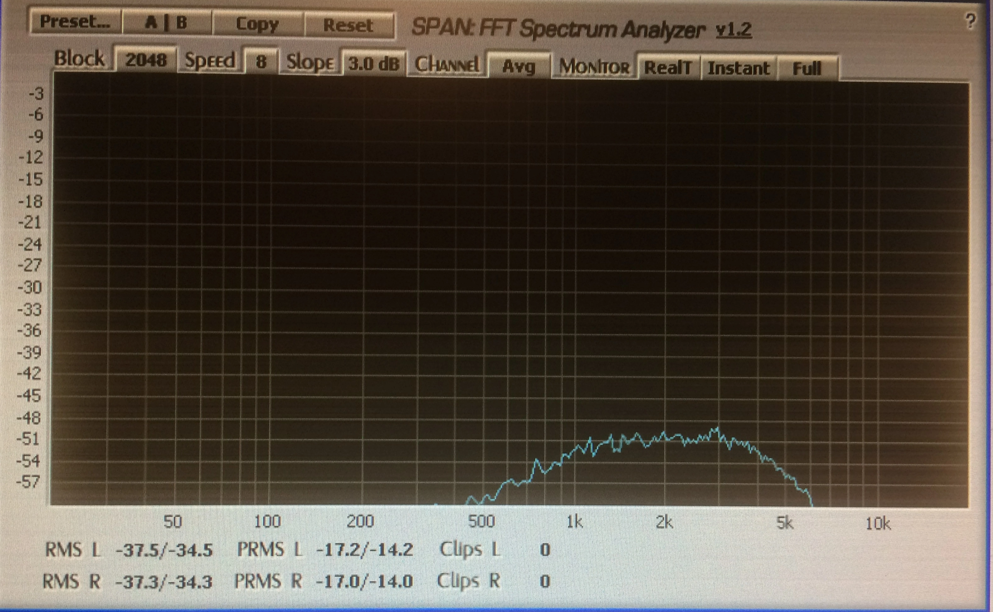

Hi,
Got a problem with a repetitive noise when recording guitar. It's like a road drill banging away in the distance.
Please see attached file which shows the noise frequencies.
The guitar is connected to an external Soundcraft mixer via a Behringer DI box and then to PC Windows XP/Cubase 4
The noise is only really a problem when I'm using a distortion plugin and I've tried more than one with the same result.
Also tried other mixer inputs but again the problem remains.
I would very much appreciate any advice please.
Thanks in advance.
Geoff

Probably data bus noise. The huge gain applied in the plug in reveals it. It usually travels on the ground in the cable between interface and computer. A ferrite ring with the usb wound a few times through it can often remove/reduce it.

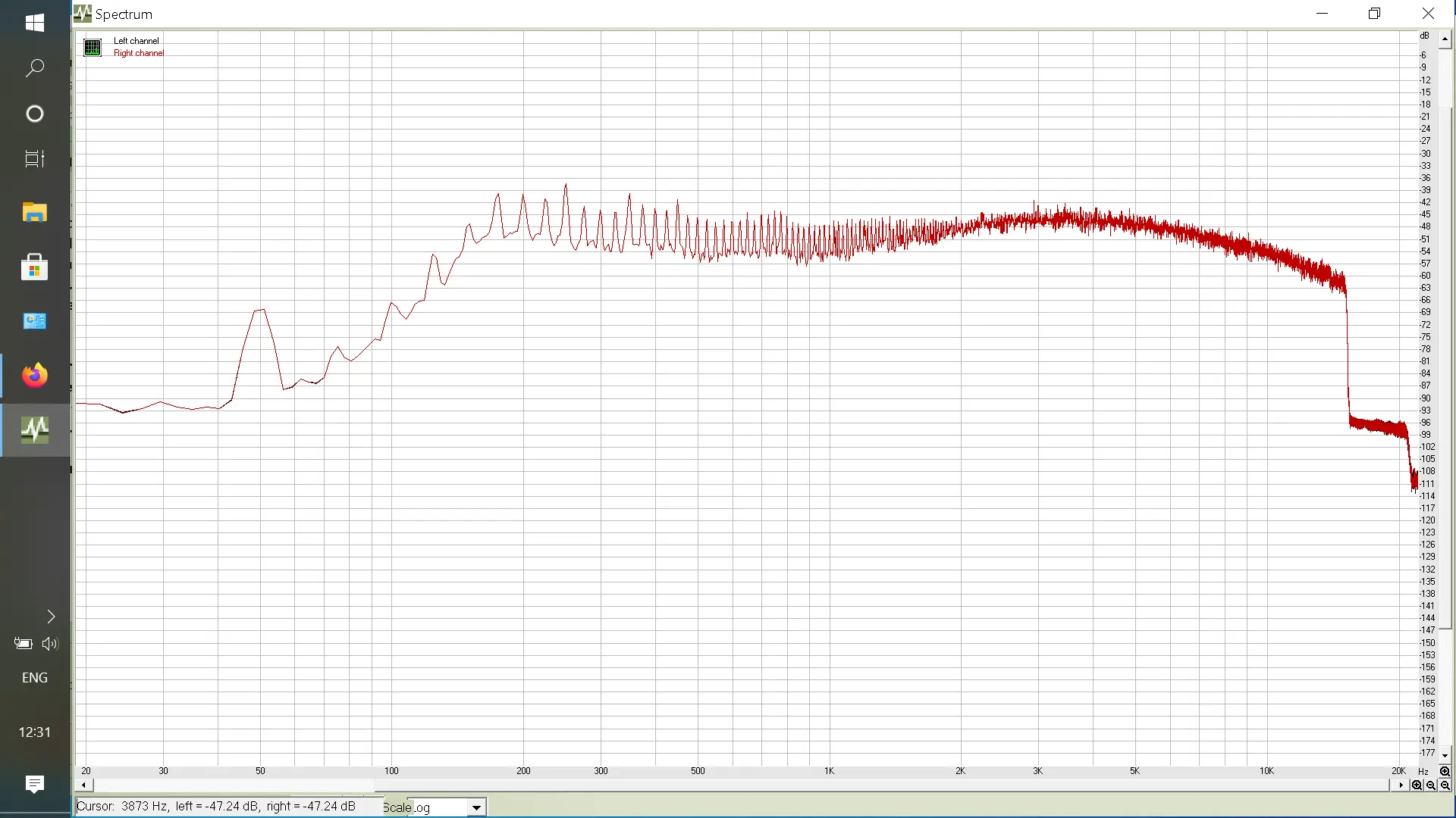

The attached spectrum tell me little. Mess innit?! I am however suspicious of that 50Hz hum just 18dB or so below the bulk of the noise? Might be worth tracking that down? Otherwise, RFI? Try some clip on ferrites?
