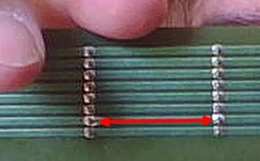

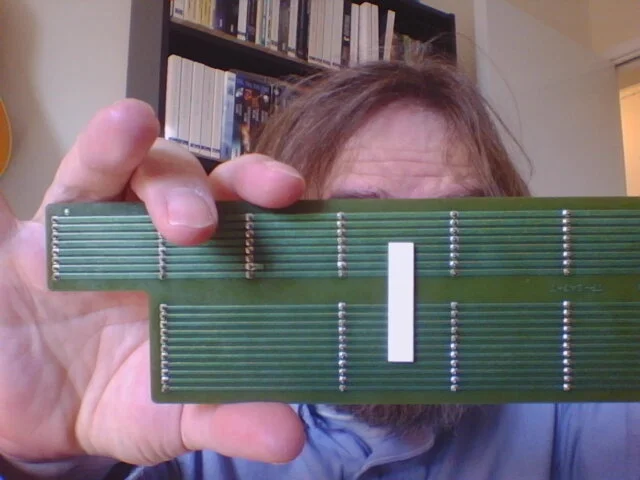

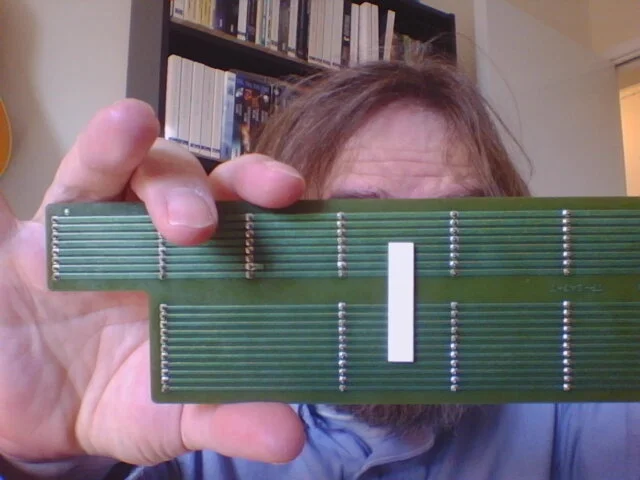

When you say a 'broken trace' - how broken, and how did it get broken? Flexing, physical damage, poor previous repair. They're not common as a fault, repairing these is usually because of damage. If you stick up a photo of the damaged area we can suggest how to do it, and what tools.
I came prepared! :D
If you're talking about the apparent break on the track second from the bottom, that could easily be repaired by running a small wire between the two solder points on either side. I don't see any board cracks, so I wouldn't expect any others to be broken.
However, since you're asking the question, I'm going to assume that you don't have much experience with soldering electronic devices, so I would recommend you have a repair shop do it. Its a 5 minute job at most, probably done while you wait.
What's a repair shop? I live in Leicester. We don't have that kind of thing here. If something breaks we throw it away and buy a new thing.
J/K. there's one on Humberstone Road. About a mile and a half away, Although they probably won't be open until July now.
So what kind of wire should I use? Bear in mind there'll be a metal base plate pressing against it when the device (my 388) it's part of is reassembled.
As Rob said, one way is to try to scrape the coating off the trace, but I would probably just use something like 28 gauge hookup wire and solder between these two points. The insulation will keep from any possibility of shorting if there is a metal mounting plate. A fine, low wattage soldering iron is all that's needed. Make sure you tin both ends of the wire first so that you get a quick and secure solder joint without heating the traces too much.

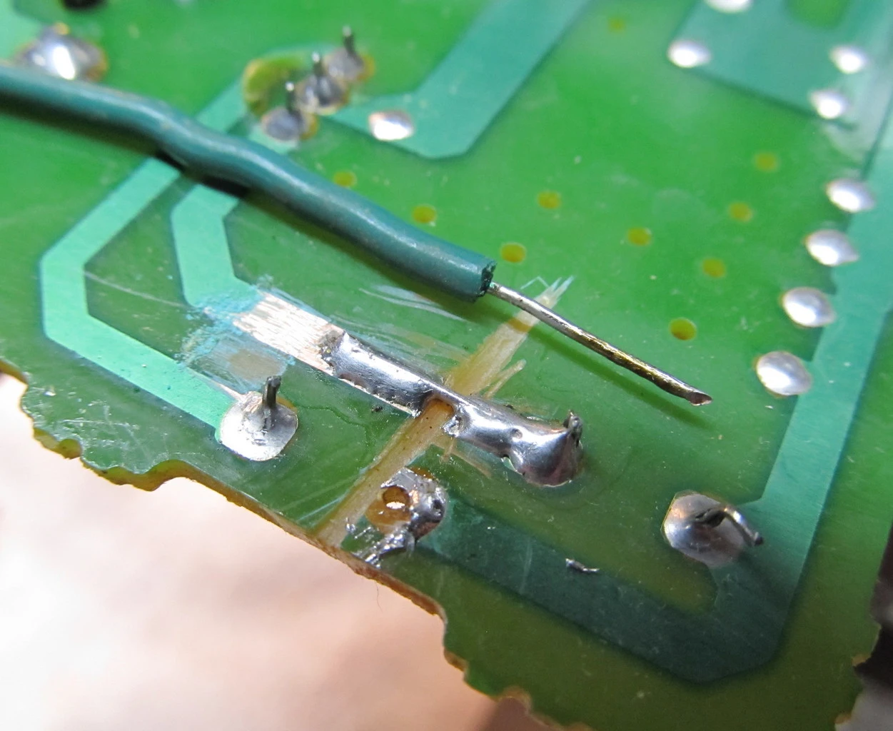

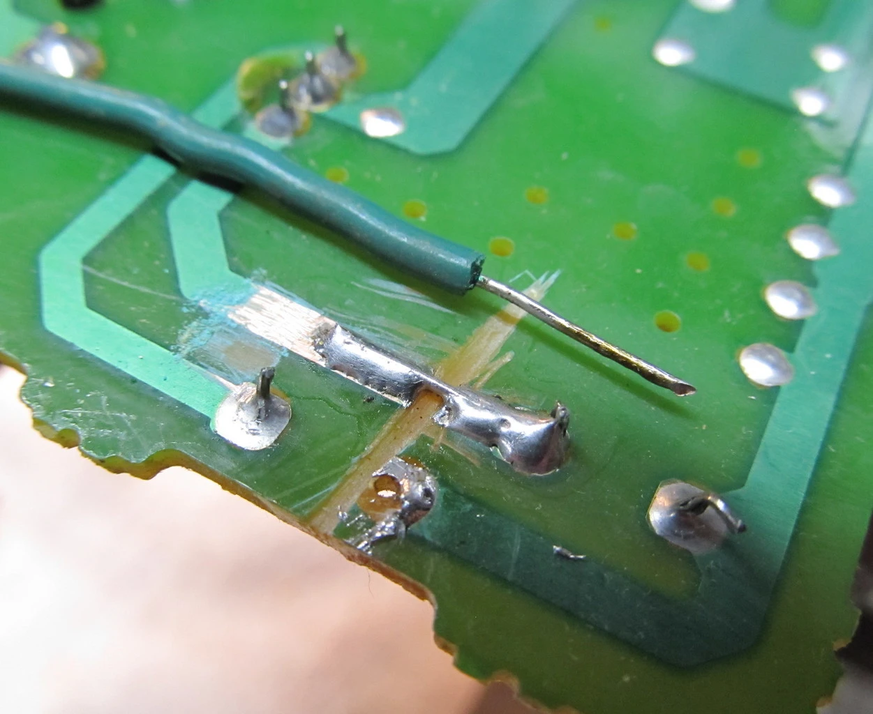

Not a neat job by any stretch, but simply a piece of scrap tinned hookup wire across a copper trace that I hacksawed to make a simulated break. The green conformal coating will need to be scraped off down to clean copper on each side. Solid wire for the bridge would be easier than stranded. Use a good quality rosin core solder and don't heat too much or the trace could lift. Try to find some old boards to practice on if you can beforehand. This was a scrap board I've saved for parts to salvage. Not sure why the suggestion to use 'enameled' wire that you would need to scrape or sandpaper the enamel coating off and then tin (coat with solder) prior to soldering(?)
