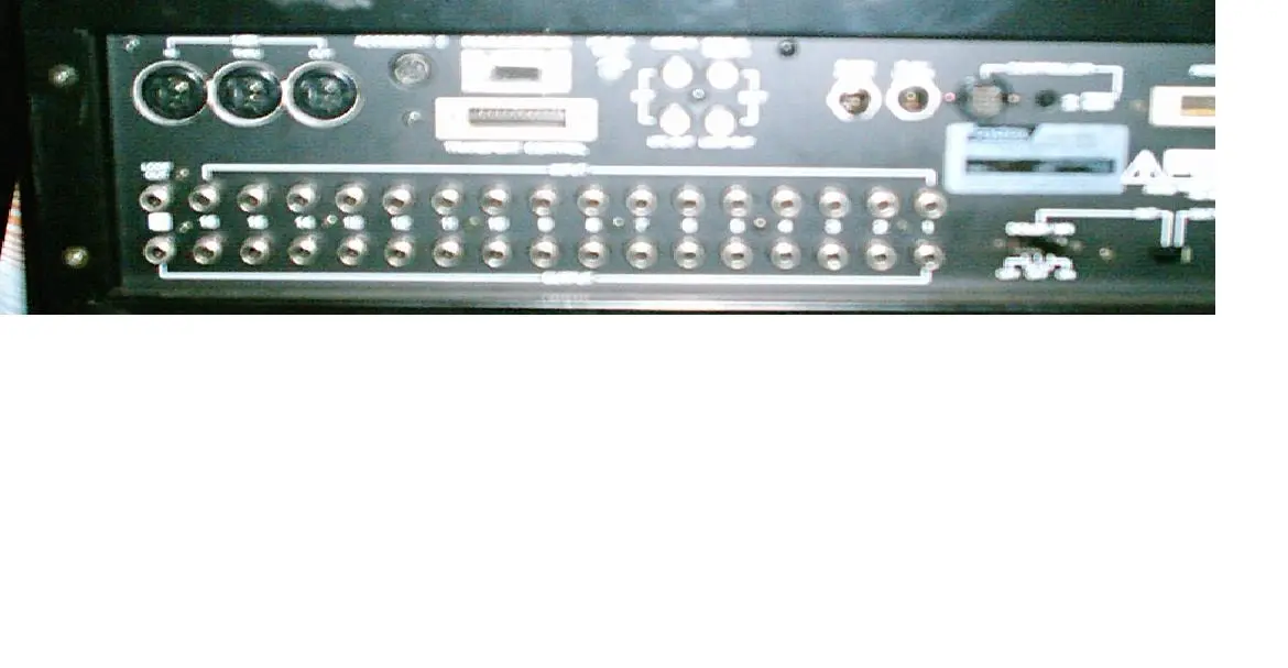

Firstly I'd like to apologise for the shakey pictures - my brothers camera is getting on a bit now......
I've been looking into synchronising my Fostex G-16 reel-to-reel with my computer system, a delta 1010lt. From what I can gather I need some sort of SMPTE code, however I also found on the back of the control module a bunch of other stuff which may be useful.
- a pair of phono-type connectors linked with a line entitled 'Int', the top connector called 'Code in', the bottom called 'LTC out'
- another pair of phono-type connectors linked with 'ext', top called 'video in', bottom called 'loop out'.
- two jacks next to one another, 'punch-in' and 'play/locate'.
- 12-pin DIN, 'controller'
- serial-type connector, 'communication'
- Mouse-type connector, 'accessory 2'
- Midi 'in', 'thru' and 'out'
- next to the track inputs/outputs there is a phono style connector, 'loop out' underneath which is another phono-type called (in bold to differentiate from track 16) '16'.
I can understand a lot of these are pretty self explanatory, but others I'm pretty lost with (LTC out?). Any ideas how I can sync this with my computer?

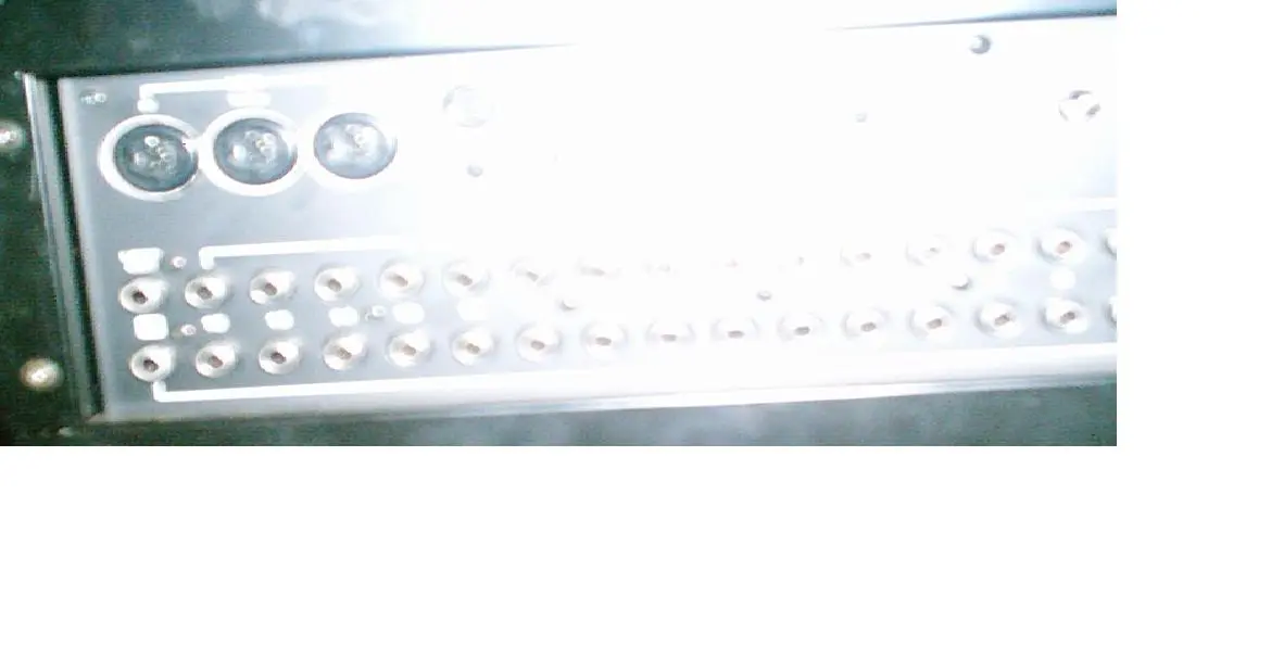

heres the second picture

You need some kind of sync box. Typically an SMPTE to MTC sync box. Since the G16 has midi on and out, it's possible that it has this built in.
Hmm. A search on the net seems to indicate that indeed it does.
As far as cabling goes, that would mean that you need to connect midi cables between your computer and your G16. How to stripe the tape and tell the G16 to send MTC should be noted in your manual.
If it isn't noted in your manual, then it probably can't and you need an external syncbox.
As stated you'd need a sync box (JL Cooper) and then strip a track of the G-16 with SMPTE time code.

Actually...
The G16 will follow Cubase.
You will have to make Cubase the MASTER.
You will need to make the G16 the SLAVE.
Cubase will tell the G16 to start playing while Cubase tells itself to start recording.
Does your computer have a MIDI interface?
You can get a MIDI interface from M-Audio.

The 1010lt has midi in and out, so I'd imagine that should do the trick.
The timing chain should be something along these lines then I'd imagine -
- midi-out 1010lt to midi-in on the G16.
- midi-out G16 to midi-in on 1010lt.
Then somehow I have to work out how to write a SMPTE track and tell the G16 this is the timing track........ Its easy to set Cubase as the master, but I'm going to have to find out how to set the G16 slave.
