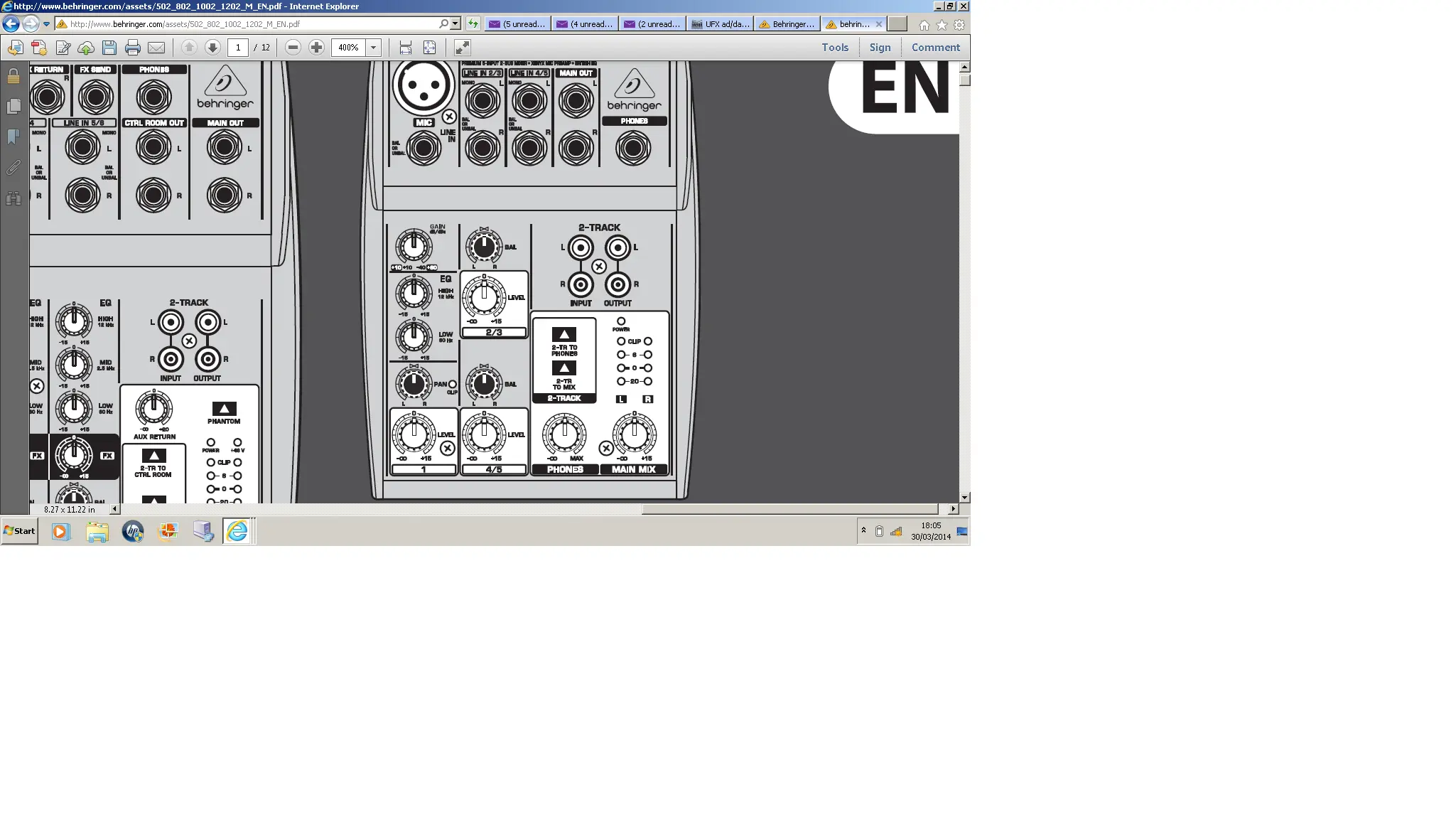

Yes, I am using XLR to XLR mic cable, so if that's wrong what should I do?, and by the way, am not sure that I quite understand what you are saying here "wrap a hanky round the mic and get your lips touching it", also for the bass control, i don't have it in 502 mixer. I hope if there is an image demonstrating the right way to setup the Behringer XENYX502 5-Channel Mixer with the Behringer UCA222 U-Control and the 33-3043 Radioshack mic, however i did it according to the manual!

No, the 502 does not have a low cut filter as do the larger models but it does have an LF EQ pot, turn that pretty much all the way anti- clockwise.
The constant "re-does" are the price you pay for recording in a noisy environment!
