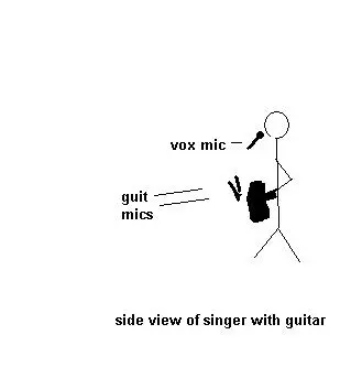

depends alot on what condensor you are using on the guitar, but I have had success using a pair of MXL603s on guitar and a SP B3 on vox this way:
Small diaphragm condensors have more accurate off-axis response than LDC's. I place the 603s in XY config at the 12th fret, but raise the stands so the mics are above the guitar, pointing directly towards the performer. Then, turn the mics so they are facing the floor. The guitar sounds will hit the ends of the mics at 90 degrees, but they still reproduce the sound accurately. PLUS, the vocals are above the mic, directed at 90degrees about 20 inches above the tail end of the mic: almost a null point on the 603s: very little vocal gets into these mics, I barely hear it at all.
Then, the vocal mic is placed pointing about 45 degrees up, right below the lips of the performer. This eliminates most of the bleed of the guitar to the vocal mic, and the singer can sing directly into the diaphragm of the vocal mic.
basically: note guitar mics are pointing down, vox mic is pointing up
