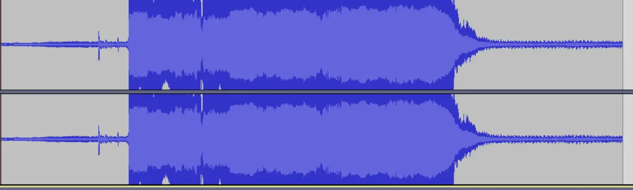

This is what happens when I record the sound from amp using USB.
What happens?

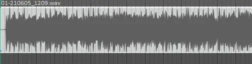

The problem is that I hear some cracking in the sound during the louder bits. I have a little suspicion that it might be my sound card. But in the picture above you can see that the recorded sound hits the max even if I'm not playing very loud. Or maybe I'm messing up something else.
Keep in mind that the big problem with USB mics is when they need increasing or decreasing in level, and the same thing might be happening with yours. Cubase, by the way is fine - but you do need to check the input levels don't clip - and of course, the reverbs in the basic version are a bit big and churchy, but there are always others to buy or get free - free ones rarely sound as nice as paid for ones of course.
I think you might need to cut the signal being recorded. The track you are showing looks like it's maxed out about 90% of the time. WAY too much signal there! Back off the volume on that channel in Cubase or from the amp (or both) and give it another try. I'm guessing the crackling you are hearing is the signal completely distorting. Your peak levels really should be about -10 or so on the meter.
The other thing that may be causing crackling is if your buffers are set too low in Cubase. That results in lost samples, which sound like the signal breaking up.
This! Unless you're incredibly zoomed in on the Y-axis (which is not the default if you didn't do it on purpose), you're clipping all over the place
