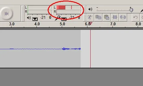

im recording some audio, but when i play it in my media player (foobar in my case), i can only hear sound from 1 speaker! if i play any other music file with foobar, i hear the sound on both speakers. only the recording sound is what i dont hear. also, when i record with audacity, only the left channel bar is moving, as you can see on the attached photo.
HOW do i fix this?
my setup: condenser mic w/xlr-cable attached to a preamp that again is connected to the usb-port. i've also got a piece of headset connected to the preamp. same thing there; i can only hear sound on left side.
i have also checked my balance on the recording tab in my sound settings on my windows pc, and it's all good there.

Somehow you have it set up to only play a mono file out of the left side. Is there a balance (pan) control on the player?
It could also be that you are recording a stereo file, with a mono signal, which would naturally play on the left (the right channel of a stereo file would be input 2 on the interface)
You either need to record to a mono file and make the mix a mono file, which should play on both sides in foobar, or you need to record a mono file, pan it center, then make a stereo mix, which will play on both sides.

What you have pictured and circled is correct. A mono audio source connected to the first, or left, input.
From there you need to make sure that your master output device is selected as stereo 1+2, and the the pan control off to the left is set dead centre.
It looks like it is, but the track you created and recorded to should be a 'audio track' from Audicty's options.
I just tested this and it works exactly as you want.
Start with a blank session, select your output device as stereo...Whatever it's called
Select your input device and L (mono), or 1 (mono)...
Hit record and audacity will automatically create a mono track with 1/L as the input and will record.
When you play that back it will, by default be set to centre pan playback through your stereo outputs.
I guess maybe the wrong option is selected in that dropdown beside the speaker graphic, to the left of your red circle?

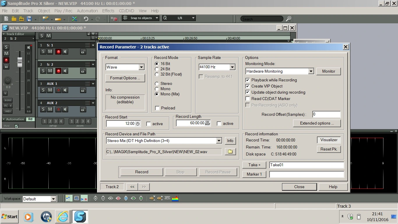

Samplitude Pro X Silver is free and is the only DAW I know of that can take a mono, one channel source and mix it onto both tracks at the recording stage.

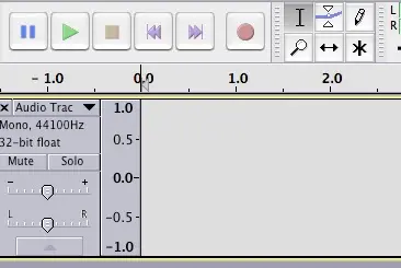

ok, im not 100% following you, steenamaroo..
i tried setting the recording channels in preferences to MONO (1 channel), and NOW i hear my recording on both speakers! but when i put it back to 2 channels, i only hear it on the left speaker, as you can see here:
now, i have kept it on mono (1 channel), but as you can see, while im recording, only the LEFT bar is moving... how can i get BOTH bars to move??
here are my audio settings in audacity:
Don't put it back to two channels. You are only recording one, so use one. Any time you record one side of a two channel input, you will only get sound from that one side.
In Sam Silver you setup a pair of tracks and then right click on the Record button on Transport.
This gives you lots of options and some are "stereo", "mono", and "mono mix" whereby a single input (mic say) on left OR right is sent to both channels.

Ah, got it to work now that i stayed with MONO (1 chan) only. thanks for the help, you all. :)

Samplitude Pro X Silver is free and is the only DAW I know of that can take a mono, one channel source and mix it onto both tracks at the recording stage. ..snip
Just curious what that would be for? Does it record a mono input to both L and R of a stereo track?
Why would anyone want to do that? You'd just be doubling your File Size for no reason. :|
I was thinking -guessing, maybe just as a utility short cut' for converting mono content to a stereo track?
