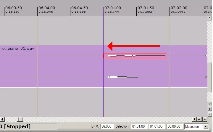

But what if I want to time stretch just part of a track? For example, one note comes in just a little late and I want to stretch it so it starts on the correct beat. Of course, I could, and probably will, retrack it, but it'd still be nice to know how to do it, if it's even possible.
I attached a screenshot showing what I mean. Hopefully it makes sense. :confused:
just split around that part and drag it over...clean up the edit by timestretching or x-fading
