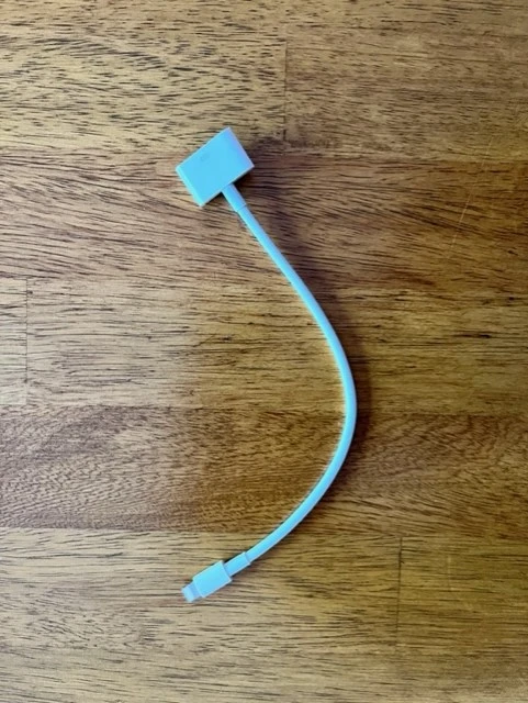

I have a Shure iM2X p which is brand new - and you can have it - you would just need a 32pin to Lightening adaptor - which is $10 on Amazon.

Sounds like the Tascam iM2X is the perfect solution... and the price is right! Please PM me with shipping details/costs. Very kind of you. Thanks very much.

Despite the kindness and good intentions of Papanate, the TASCAM iM2x (30-pin connector) would not work with my iPhone 13 (Lightning connector). I contacted TASCAM and they responded - The iM2X does not work with newer iPhones, it only works with older iPhones that use the 30 pin connector.

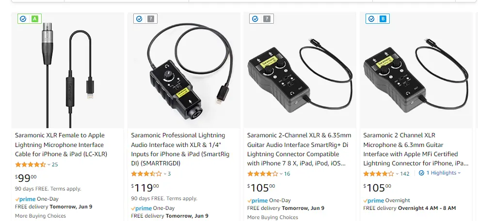

Using any regular cardioid microphone like a shure sm 57 or 58 fed through any of these below will give you gain control and the ability to eliminate the distortion...the 2 channel can provide a stereo recording for the iphone.

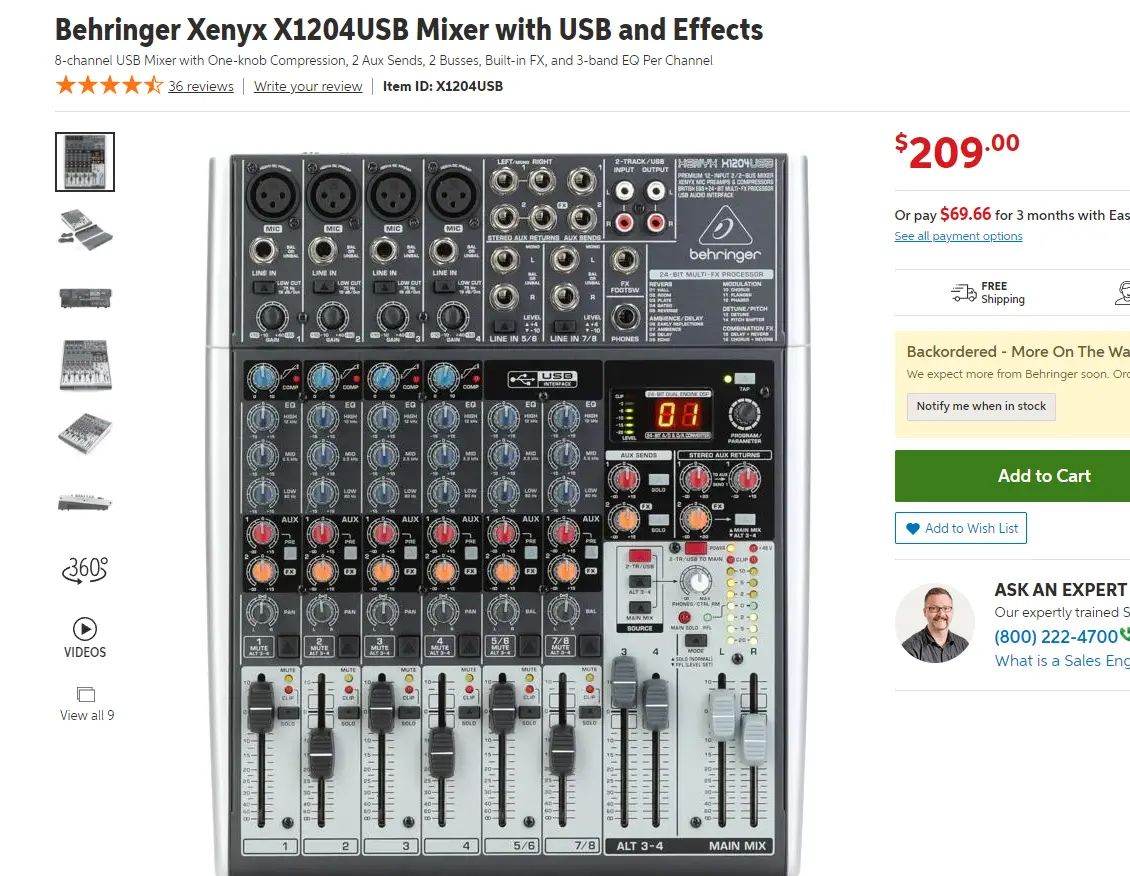

So I record my little "one shot live" videos on my iPhone and plan to (Hopefully) do a bunch more this year...I use a Behringer 1204 usb to run my keys and microphones through and have zero issues with controlling the volume to my iphone audio on the video I shoot..What I hear in my headphones is what is going to the iphone.
The mixer adds that extra level of being able to monitor what is going in rather than the usb connectors I posted previously...The Saramonic options I posted previously gives you the control over the volume going in...just no way to monitor it that I know of ( there is probably a way)
Here's the mixer I use.. A little tricky figuring out what buttons to push up or down to get the usb out and be able to monitor but once you get it, it works great...
Below as an example is one I recorded live and direct through the Behringer

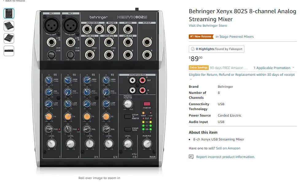

With either one or two mics into this one will get you what you need for volume control ( and ability to monitor) into the iphone via usb to lightning cable (Apple issued)

If you read my original post, this all much more complicated than what I am looking for - the ease of simply using my iPhone with better (stereo) microphones and a way to limit the input volume (LED's and headphone output). The Zoom iQ6/7 both have these features but no one (so far) has been able to report any field use. You are very knowledgeable about the technology and the end result is excellent! Thanks.
