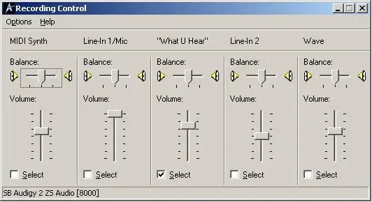

Control panel>Sounds and audio devices....hit the 'advanced button'. A mixer of some kind should appear. Goto 'properties' in the menu bar. A dialog box pops up. Click the 'recording' radio button. A list of check boxes will appear. Check "What U Hear". Click OK. The mixer should change to the recording mixer, with a "What U Hear" fader. Mute it.
That's not the options for a Soundblaster. It will be "Stereo Mix", NOT "What U Hear" :eek:
Also, Ethan pointed you to a great resourse. Check it out ... and learn. :cool:
Actually I have a Soundbalster, an Audigy 2 in fact, same as the OP (not that I use it for recording). I wrote that as I was doing it myself on screen. So, I don't know what SB you are using, but those are the settings for an audigy 2. :)
:eek: I stand corrected ... mine shows STEREO MIX. Maybe, it's the drivers.
