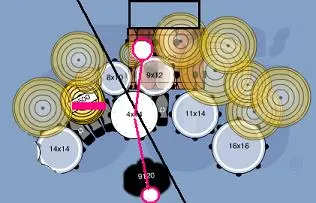

Heres how I'm pictureing it....but is this right? I think i've misunderstood as i cant see how this creates a stereo image.

That is exactly right on how to place the overheads. Also, I would put them about 6 feet up....lower and you'll pick up more toms, higher and you'll pick up more cymbals.
It creates a true stereo image with the snare and that tom in the center.
Yes, put the kick drum mic in the "tunnel" under the chair. Try it however you like it - I use full front heads without a hole in them. You could also build a little fram out of PVC pipe instead of using a chair, or I've even seen guys use a cardboard box. and had the mic between the box and the kick.
The blankets need to touch the floor on each side, because you want to isolate that area in front of the kick as much as possible. That will help keep the snare and cymbals out of the kick's mic.

The Reson you aren't getting it is that, you're still thinking in the terms of Kick on the Right, Hi-hat on the left. Normally, with "standard" overhead micing techniques, most of the stuff is on the right hand of the kit. By mic'ing it the way I'm showing you it evenly splits the drumkit with the snare in the middle.(I didn't invenet this. Australian Producer/Engineer John Sayers - right here on Hom Rec - is where I learned it)
For more info on this do a search on John Sayers, and you should be able to find what he wrote about this.
I can't really explain this overhead technique , other than to say it made my recordings seem, a lot "wider" and more of a "stereo" image than what I had before.
I was wrong...the mic'ing placement is right, the line was wrong. I don't what I was thinking, and I knew that the picture didn't look right.
Draw the line through the Kick and Snare.
That will give you th stereo image I was talking about.

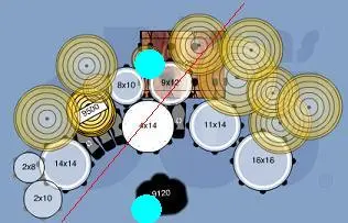

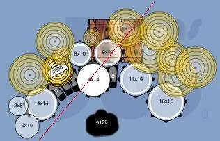

I see... this is what i use when recording standard 5 piece set ups. Also like i asked in the post before about the kick having enough attack, with my crap kick mic?
I've put the mics where i think you mean... sorry if im repeating myself. i just want to make sure i've totally understood you correctly.
This is new image correct?
Thankyou for helping me so much and being so patient :D

The Line is just the center line that is the divider where the sterreo image is.
The Mic placement is still the same.
One mic back behind your floor tom, and one in front of the hi-hat with both aimed at the center of the snare.
