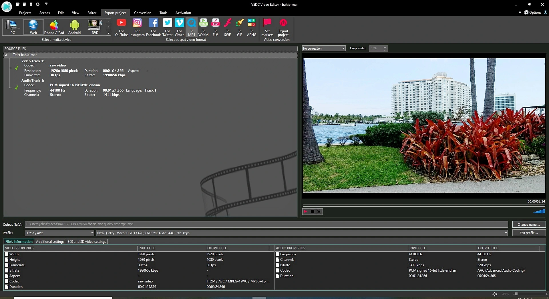

Also if it's of any use here is a screenshot of the exporting control Panel. I experimented today with exporting in the same MP4 format using that Quicktime Icon, and I have to say! the video is quite good with the additional audio track on board! I seem to remember in the past when I made some changes to clarity or contrast, I then exported to MP4 and the file grew to double it's size for some reason? but as I said! I was probably doing something else wrong! ...Thanks again for all your Help John

Just as FYI... Most video today has a 48k audio track, not 44.1 which is the CD standard. Just about any audio editor will do the conversion, Audacity, Reaper etc. VSDC may do it on the fly. I don't know that it makes a difference for viewing on phones, but if you ever burn to DVD, you want to run 48kHz.

Thanks I will make note of that! TalismanRich
