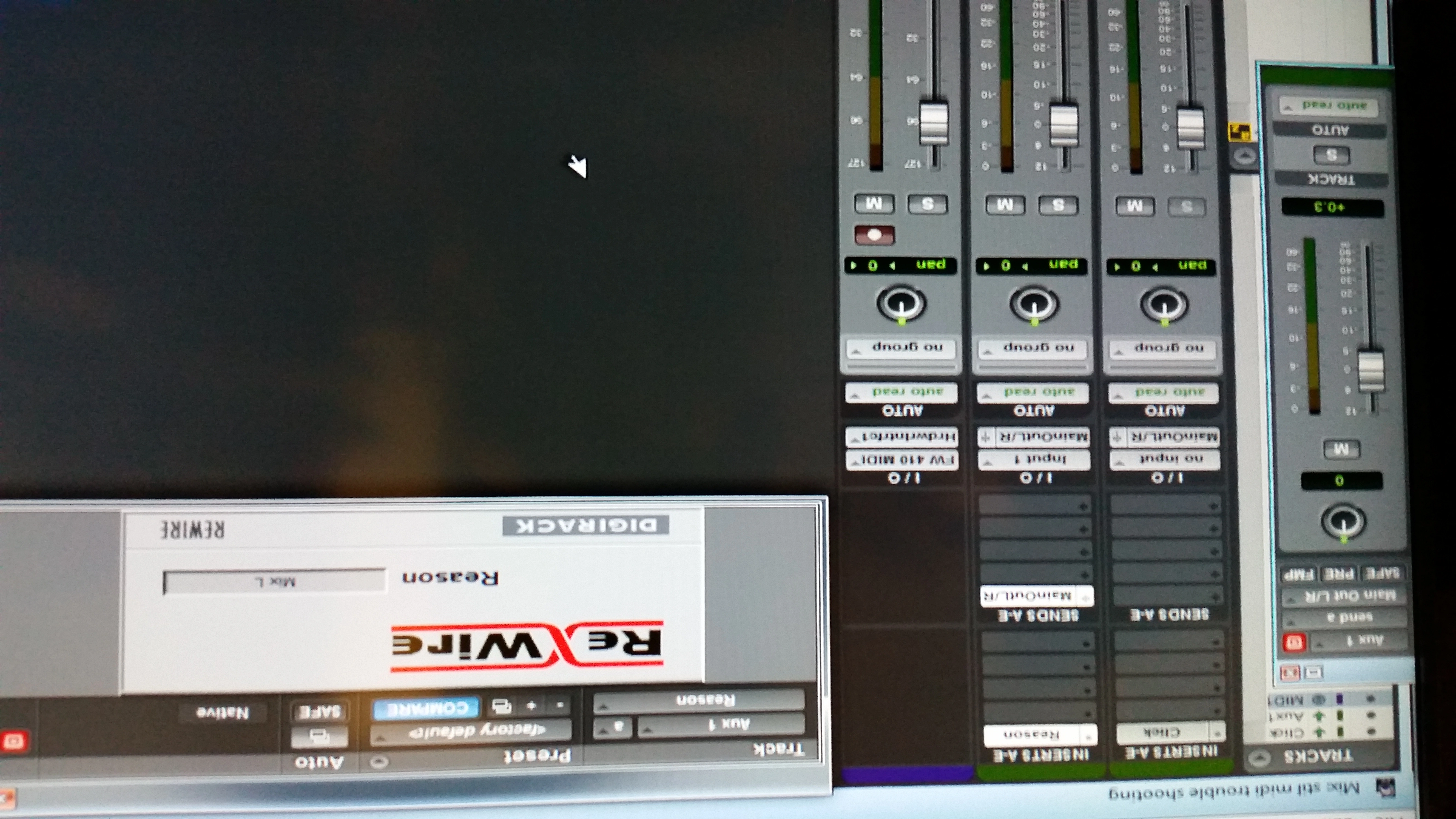

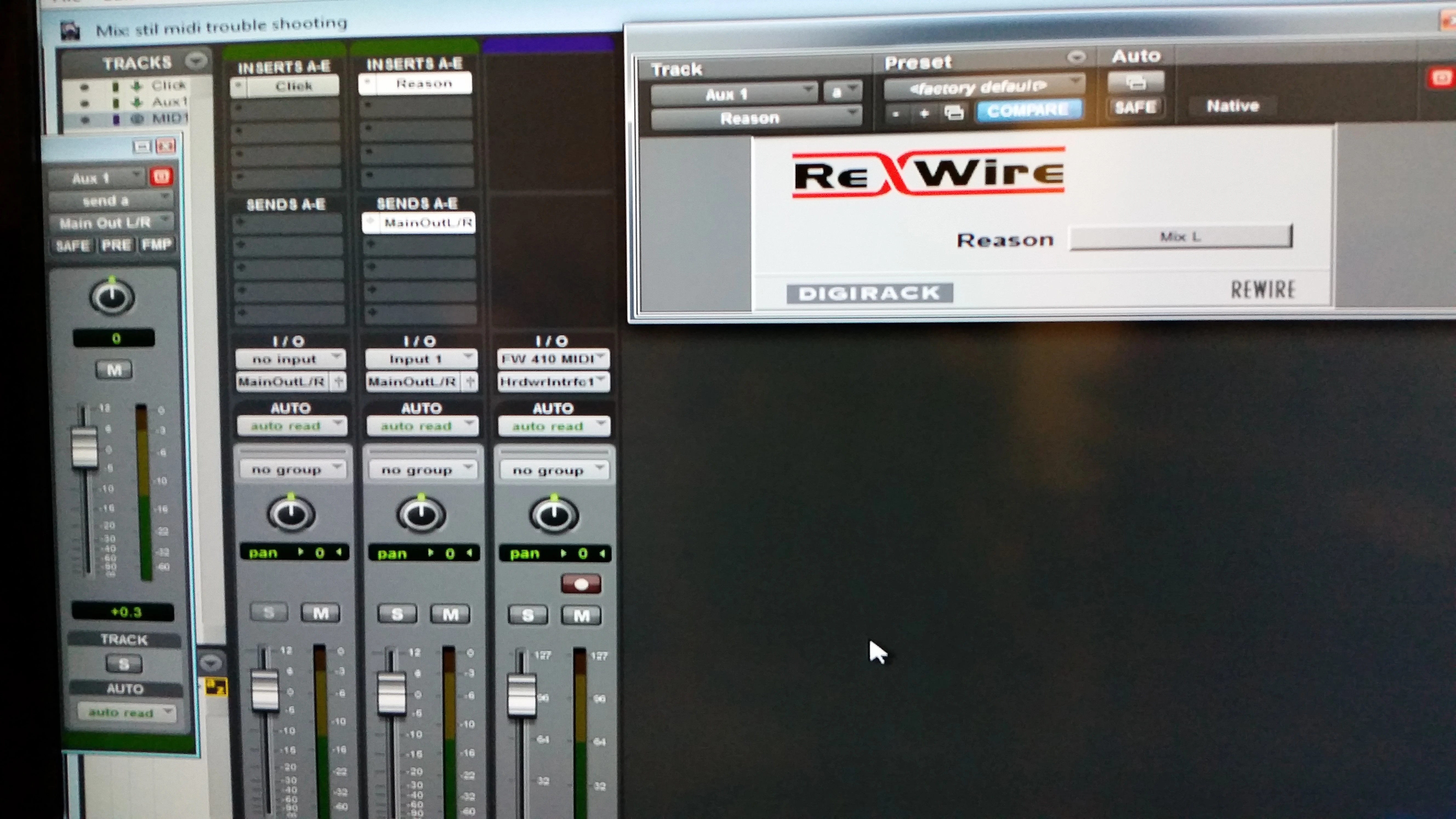

Hopefully this picture attached...this is what my mix window looks like. I have tried diff variations of the I/O's and I am still getting midi recording with no playback. In previous sessions, I have tried to use an Instrument Track for midi, but tried a Midi track this time, as guitargodgt suggested. Can anyone spot what I'm doing wrong?

Standing on your head? :D
So, no... not exactly. If I want MIDI data to play an actual instrument in Reaper, I have to assign a virtual instrument to the track to make it so. I think that's from Step 8 on in guitargodgt's list there. Unfortunately I can't help you with ProTools.
Frustrating though this undoubtedly is for you, rest assured that this is actually the easy bit - just a matter of working out the exact method. I just googled "Assigning a virtual instrument in protools" and got a shed load of info... could be worth a try if all else fails.
